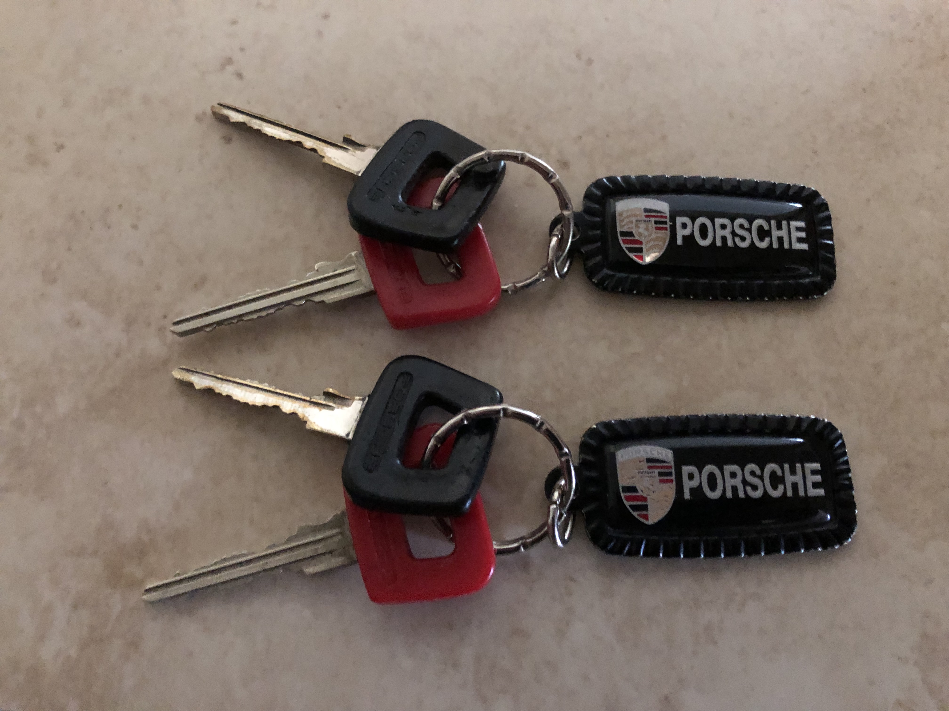

Finally got around to looking at the broken key. Got it out very easily with a pair of tweezers. Had to remove the steering wheel to get a good view.
About the Steering wheel, it turns out the key chain got stuck between the wheel spoke and the horn button. As I was backing out of a parking space and spinning the wheel to the left, my hand hit the key chain and miraculously the key chain (leather) got stuck and as I continued to turn the wheel, I felt a resistance as the key was being bent.

Member No.: 10,102
Curt made my keys from a picture. I see you have a picture, might want to edit that part out.

QUOTE(mate914 @ Jan 13 2026, 02:57 PM) *
Matt
Curt made a key for my 914 from only a picture of the key as well. I used a similar service to make replacement keys for the two 911s. So yes, you may want to consider removing that picture from your post (IMG:style_emoticons/default/sad.gif)
