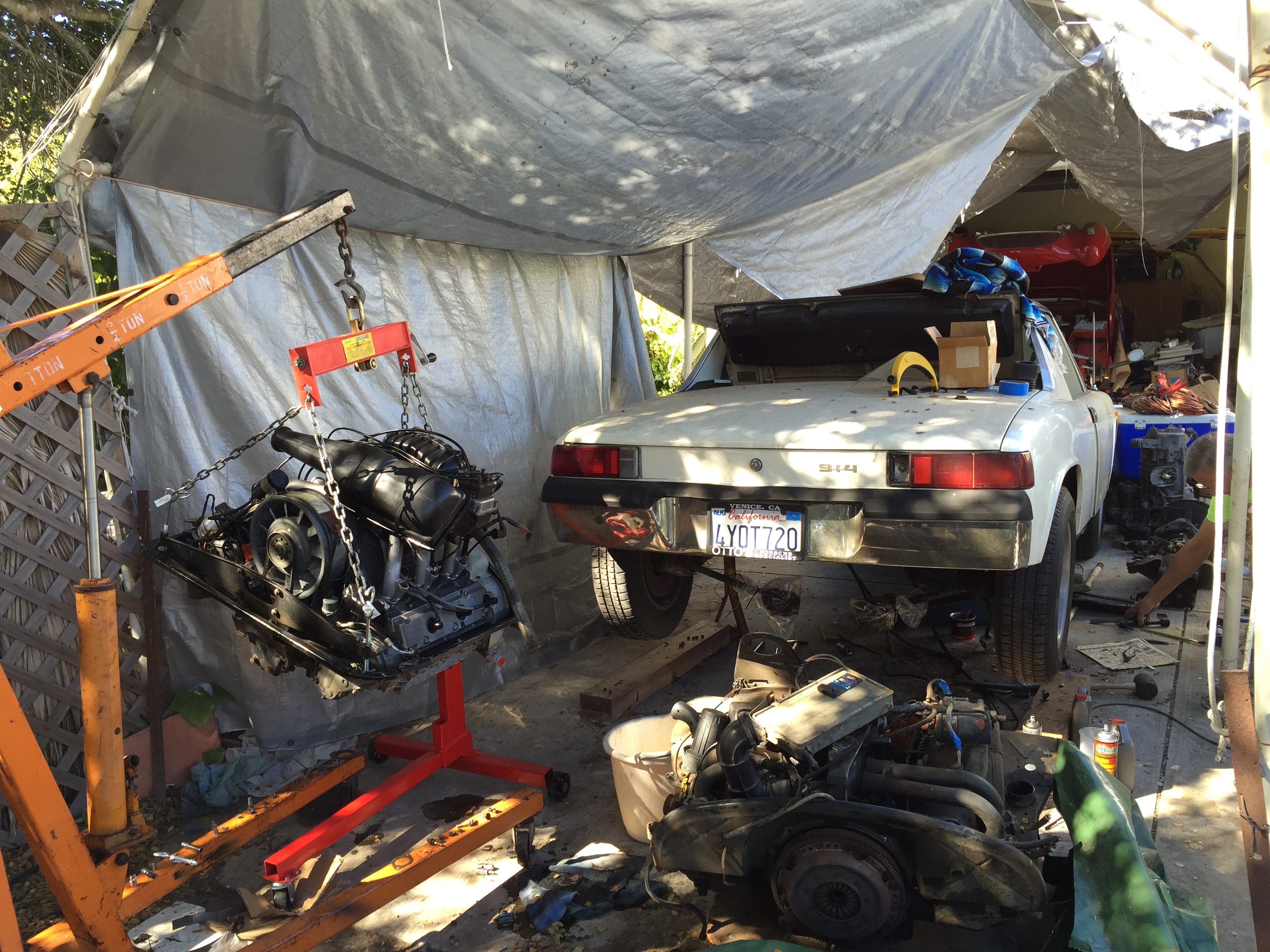

Here is a photo of the car in Oct 2014 and as you can see it really has not moved much since then.Attached Image
