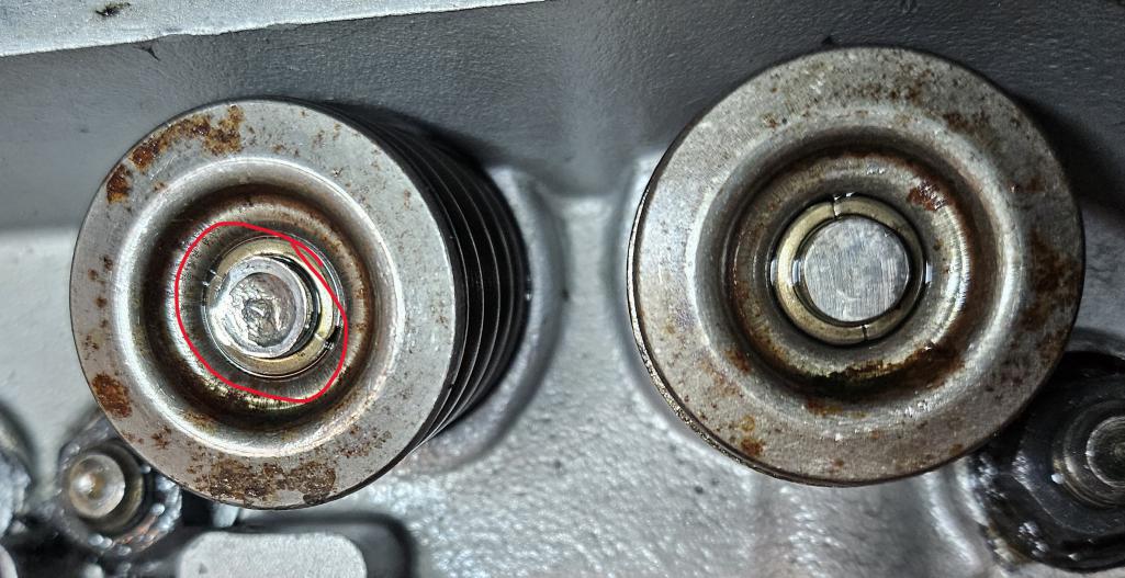

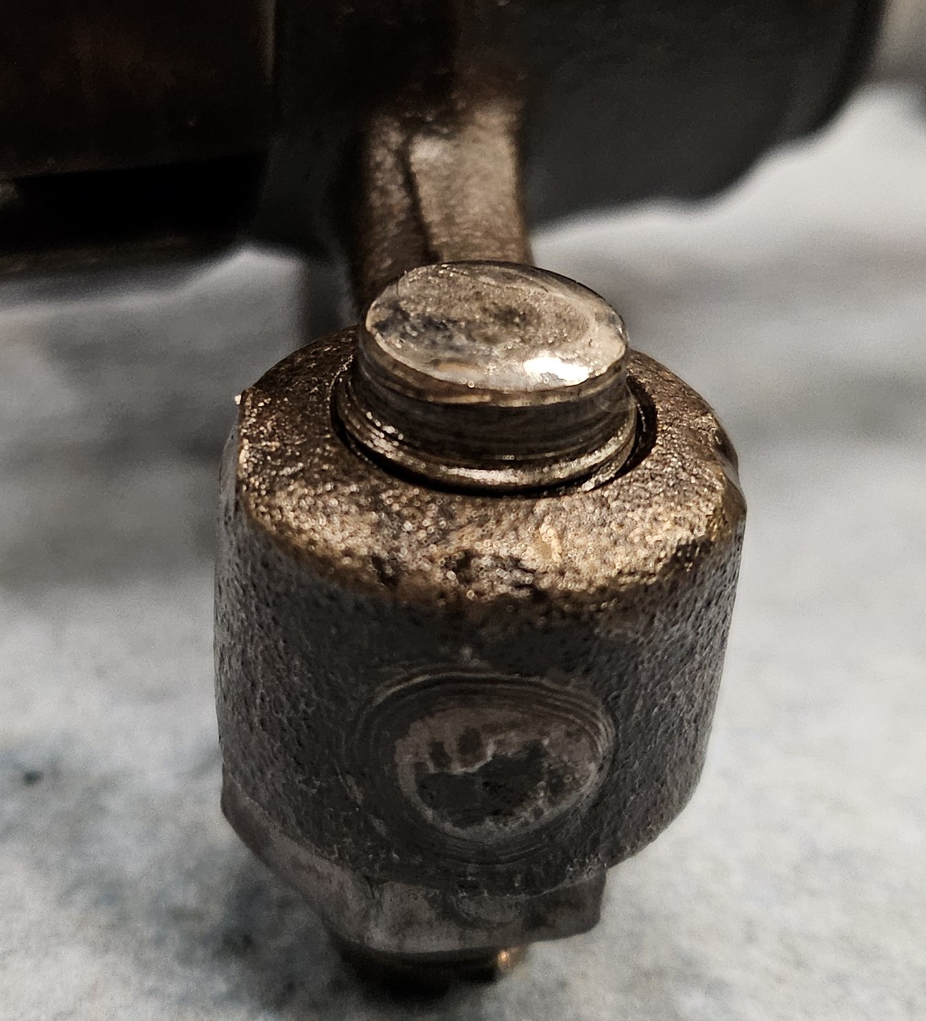

Hello,
I started replacing the Pushrod Tubes yesterday, and I noticed that the top of the stem of #4 intake valve has a divot worn in it from the rocker (#4 valve stem & rocker adj screw photos below). The other three valves on this bank are fine, and I haven't pulled the rockers on the other bank yet.

I do not see valve springs listed on the build sheet, so I am assuming that the single spring currently installed is the OEM spring, and not an HD spring.
So, I have two goals here:
  1. First is a short-term fix as I plan to take this car to the Hill Country Rallye in Mid-March - so no big tasks that might go off-script. Car will be driven 600-700 miles during this event.
  2. Second is post-rallye where I plan to move to 1.7 rockers with swivel-feet, chromoly PRs, set valve geometry, and whatever else folks might suggest while I'm in there (solid rocker spacers?). And can this valve be saved? Am I looking at pulling the head to either repair or replace the valve?
For the short-term goal, if I leave things as-is this will obviously make setting the valve lash on that valve challenging. So I would like to hear folks' opinions on the use of a Valve Cap on that one valve (and any others with similar issue I may find). If I install a cap, should I replace the rocker adjustment screw for that valve as well? Or is there any other short-term option that does not involve pulling the head? Or just run it as-is knowing that #4 intake may not be getting full lift, and tear into it after the event?

I'd rate that as toast...
Unless you know the age of the valve springs, I'd replace them before I ran it again.
On that I'd expect R+R heads, valve job, new valves (as required, auto change any sodium critters), springs, retainers, keepers, swivel feet adjusters and guides as needed.
Pull heads, clean the crap out of the combustion chambers, and look for cracks before spending any money. Exhaust side near plug is the usual propagation point.
It MIGHT be possible to machine the damage off of that stem, but it looks trashed to me.
Put it back together as is and drop a valve at 4500 RPM...
I've got a box stock 31K 914 that runs OK and I won't run it again until I replace the springs/retainers/keepers. Some of mine sat open (in compression) for 33 years.
Too many resurrection threads on here have been terminated over dropped valves.
