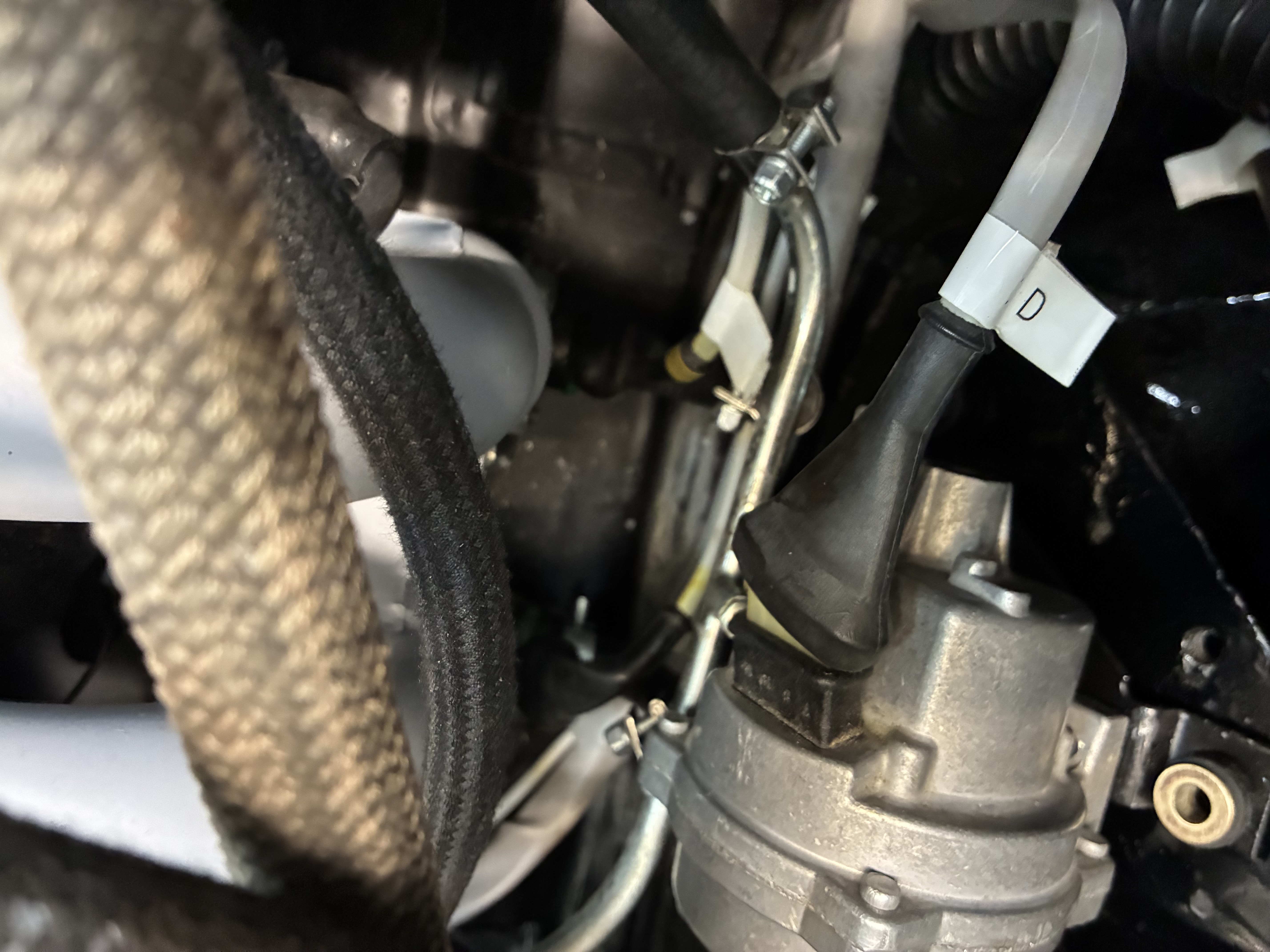

Should I shorten the injector hose to lower the fuel rail that seems to be in the way to install the MPS. Does anyone make special pre-bent injector hoses? I am having a hell of a time installing the MSP

Can't quite tell but is that the rail that should be on the drivers side? The proper one for the passenger side (under the MPS) doesn't have the nipple in the middle of it going up.
The hoses from the rail to the injector are pretty short...914 Rubber has em.
https://914rubber.com/fuel-injector-line-el...red%20per%20car.
and here's a link to the passenger side rail:
https://sierramadrecollection.com/products/...FQaAty9EALw_wcB

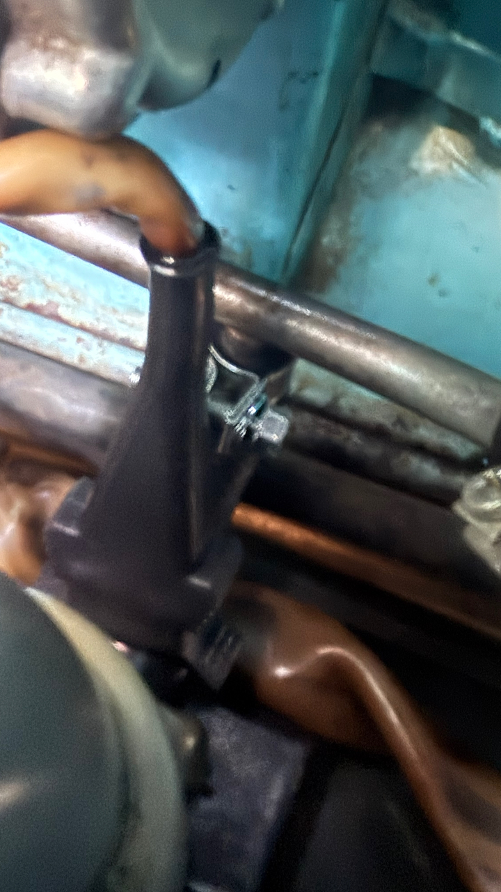

Here's a pic of my passenger side rail - you can see the MPS above to the left - and the how short the hose under the rail is.
