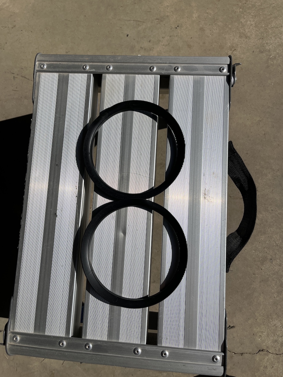

QUOTE(914Sixer @ Feb 13 2026, 05:33 PM) *
I have some used sealing rings, not sure IF early or late.
@914Sixer ,
Based on the recent photos I posted of the early & late sealing rings, which ones do you have available?
post Feb 15 2026, 03:55 PM
Posts: 9,416
2 Early that I could find
