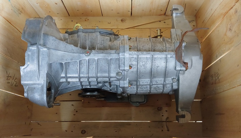

Curious to know what other people's set up is with their speedo sensor on their cars. I have a 915 gearbox (on a 3.2 engine) and have had to pull the sensor out of the case as the speedo needle was bouncing. (Had the speedo rebuilt and checked the earth to it).
See photos. Obviously not a normal set up given the box is flipped from a 911 and a previous owner has made up something that was working. I haven't cleaned the sensor yet as that may do it but curious to know where this sensor might have come from (it looks like it's been broken out of a larger body/housing) and what others have on their 915 or 901 set up.

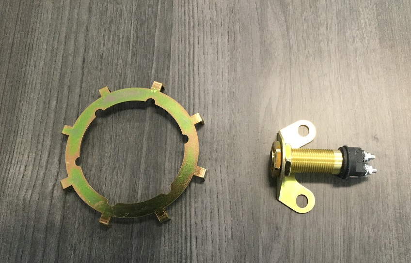

The remains you see on the end of the wires are those of a magnetic reed switch. As the magnets on the disc attached to the differential fly by each triggers a contact closure and the VDO electronic speedometer converts those into speed information. All you really have to do is replace the reed switch and replace the sensor in the hole that the previous owner used to get the reed switch close to the passing magnets inside the transmission case. I have the exact same setup on my car ("78 911SC engine, 916 transmission) only I made an aluminum piece to contain the reed switch, milled a matching hole in the trans differential cover, and cemented it in with Locktite red.
Biggles
Thanks for that. Very useful. I won't have time in the next couple of weeks to take the side plate off to inspect but would be useful in the meantime to see any pictures of your set up if you have them or what parts you used?
