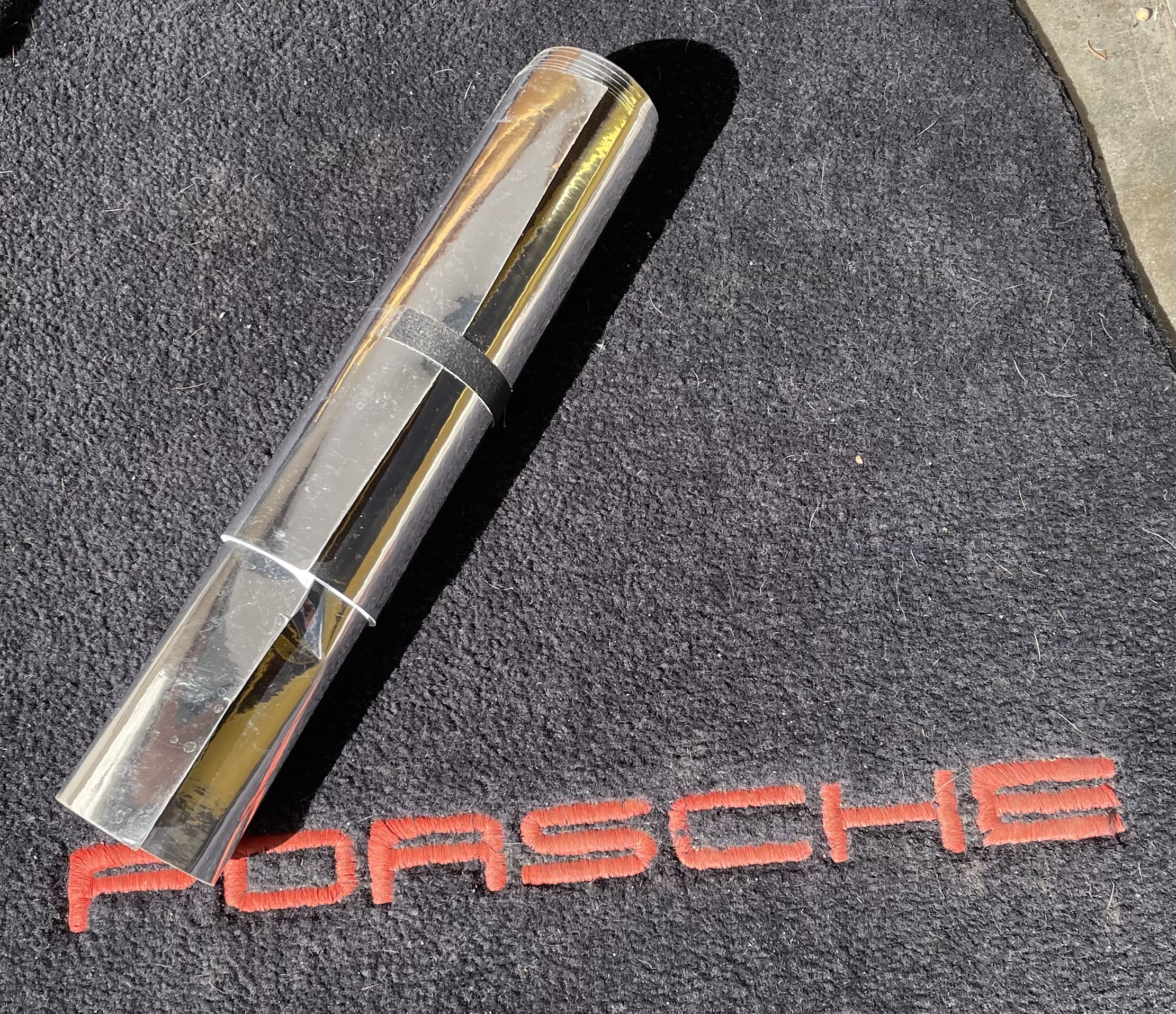

QUOTE(Superhawk996 @ Feb 18 2026, 08:46 PM) *
Window tint across top 6” is effective and cheap. Go with mirror tint if you want deeper shade assuming it won’t cause issues with the PoPo in Texas.
Dirt cheap. Easy to install.
If you’re dead set on vinyl go see your local sign shop - they can cut vinyl for you if you give them some dimensions.
Thanks - TBH I’m not crazy about the mirror finish.. but your post reminded me that I do have something very similar already, see pic “chrome vinyl”. I can use it for getting a good pattern, and easy of install when I get the correct material.
post Feb 19 2026, 12:06 PM
Posts: 7,697
Just keep in mind you can get the same type of product that is just conventional tint in a wide variety of light transmission. If I recall Texas allows some pretty dark tint.
Or . . . You could use the mirror vinyl then have your local sign shop cut some fluorescent vinyl letters to make the Andial logo 80s style. Lay that logo on top of the mirror vinyl. One of a kind! (IMG:style_emoticons/default/aktion035.gif)
Just sayin’ (IMG:style_emoticons/default/poke.gif) (IMG:style_emoticons/default/laugh.gif)
