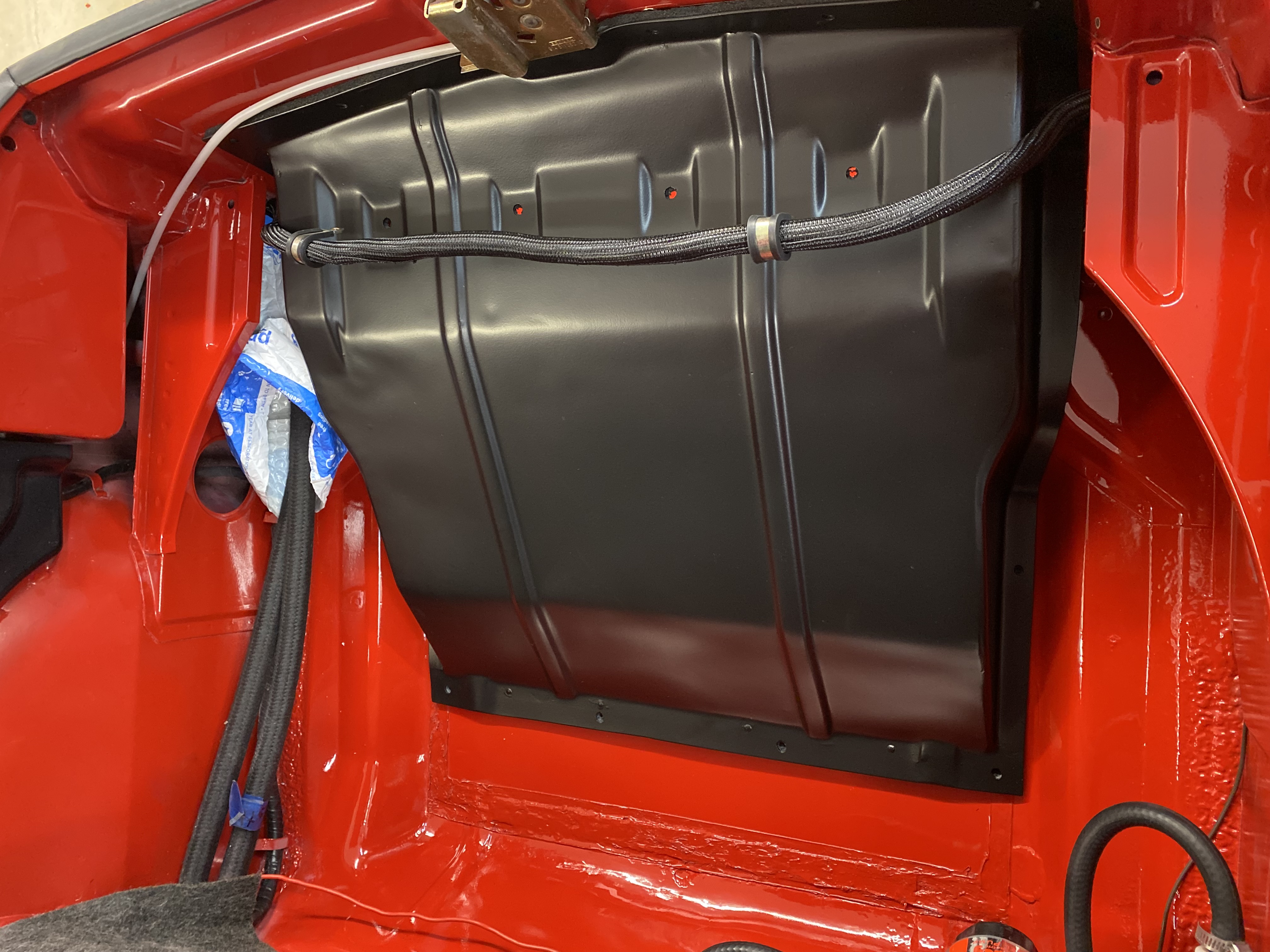

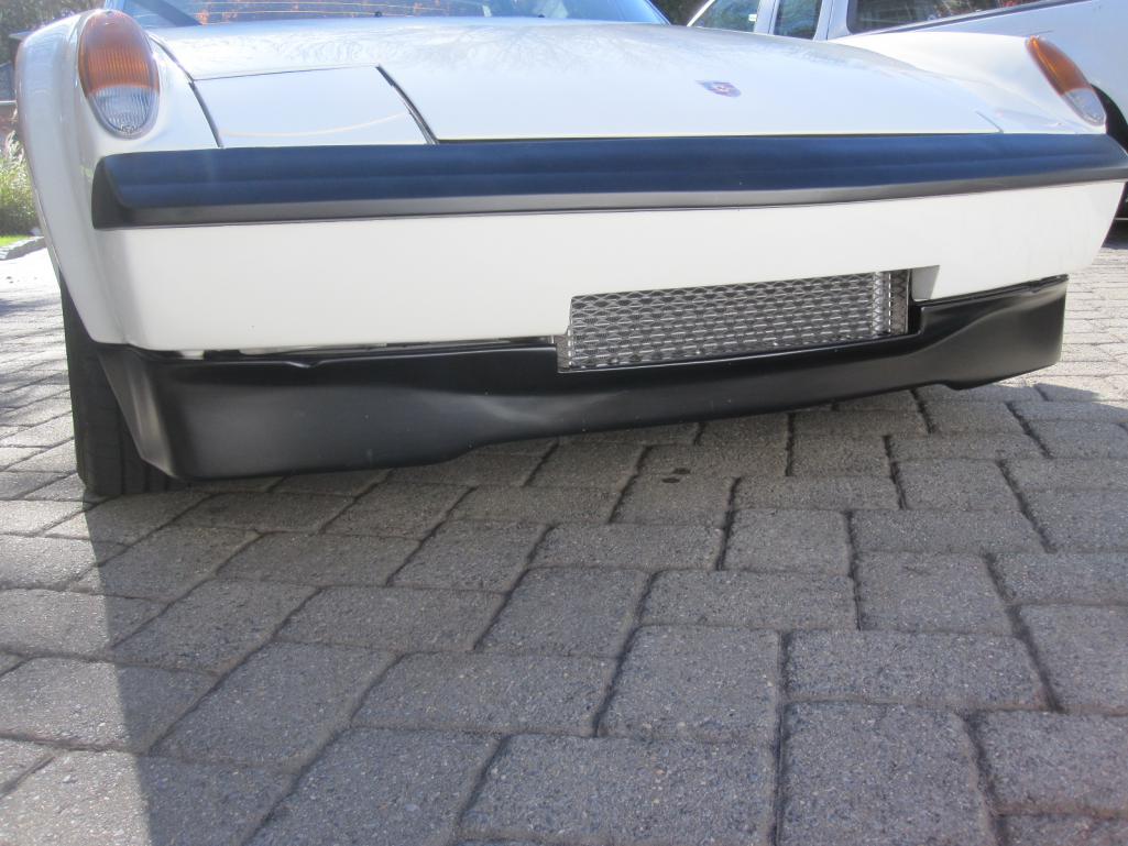

Hello,
Anyone have experience with this bumper?
Trying to sort out a front bumper solution. It's already fabricated to pair with the GT style lower shroud. I bought that from PMB which I'm working on for the proper fitment (as expected)
AIR- American International Racing
https://americaninternationalracing.com/pro...4-front-bumper/
Fiberglass with integrated bumper topper as once piece.
I'm close to finishing the previous owner redo of the front oil cooler/ lines, shroud, valance, and bumper combo
The PMB sourced shroud is looking good! Shout out to Eric and the crew for all their product support.
roundtwo

post Feb 19 2026, 11:43 AM
Posts: 10,575
That shroud looks perfect!!! (IMG:style_emoticons/default/beerchug.gif)

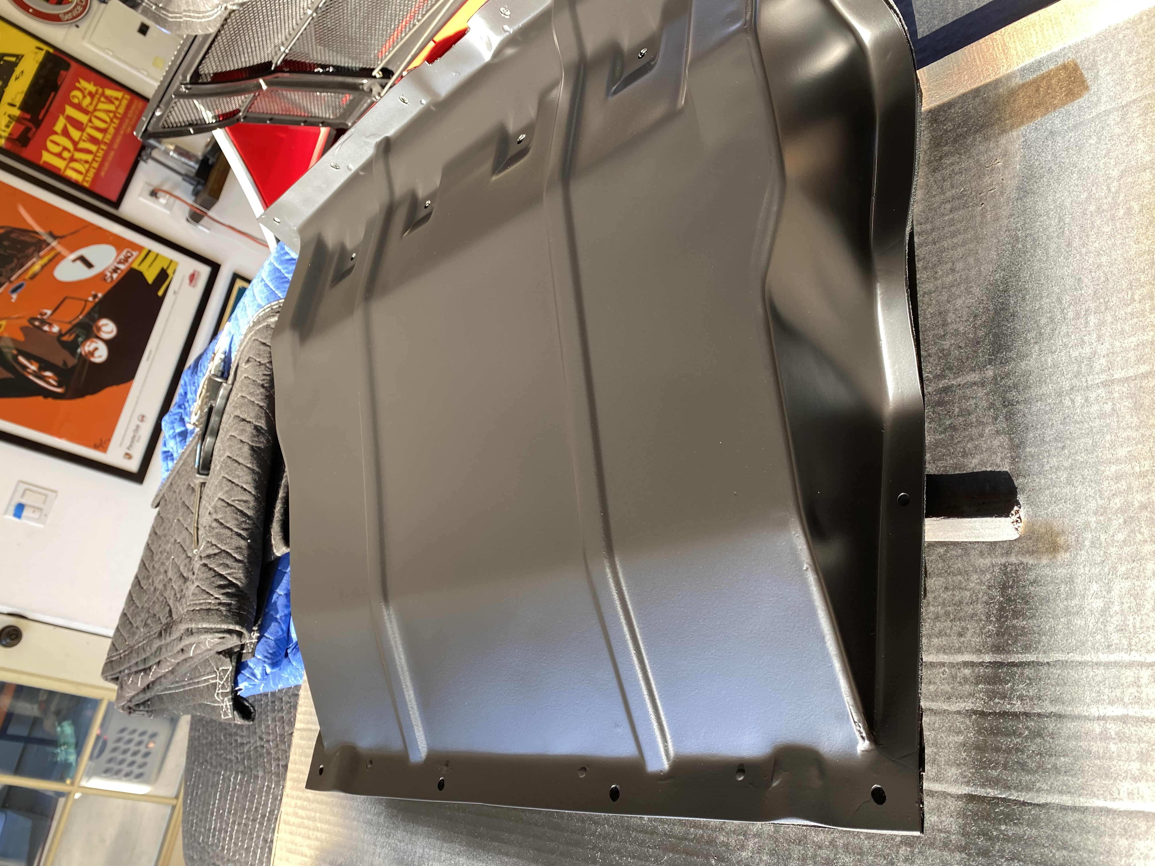

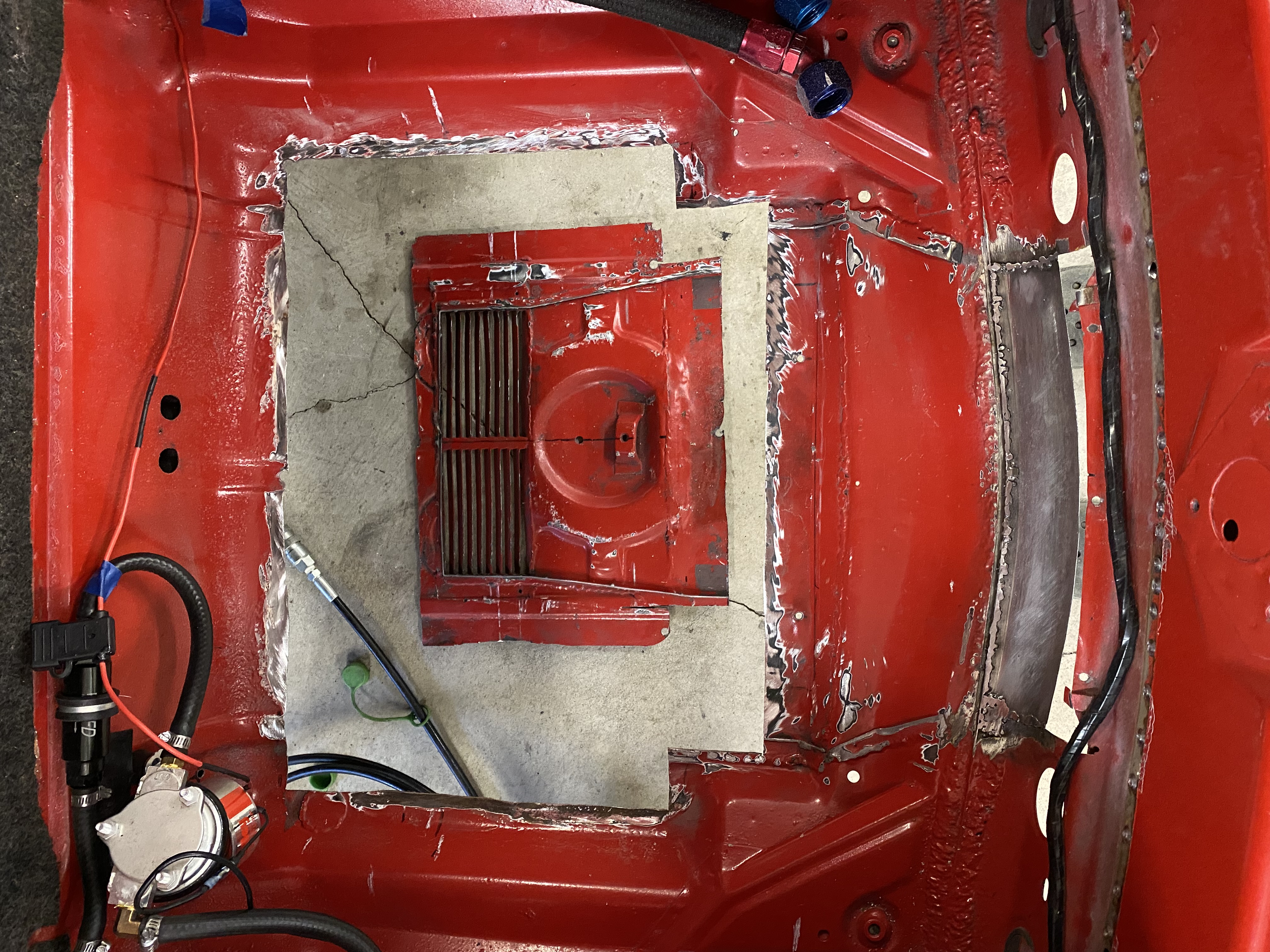

QUOTE(Cairo94507 @ Feb 19 2026, 09:43 AM) *
Thanks Pal...it's coming along!!!

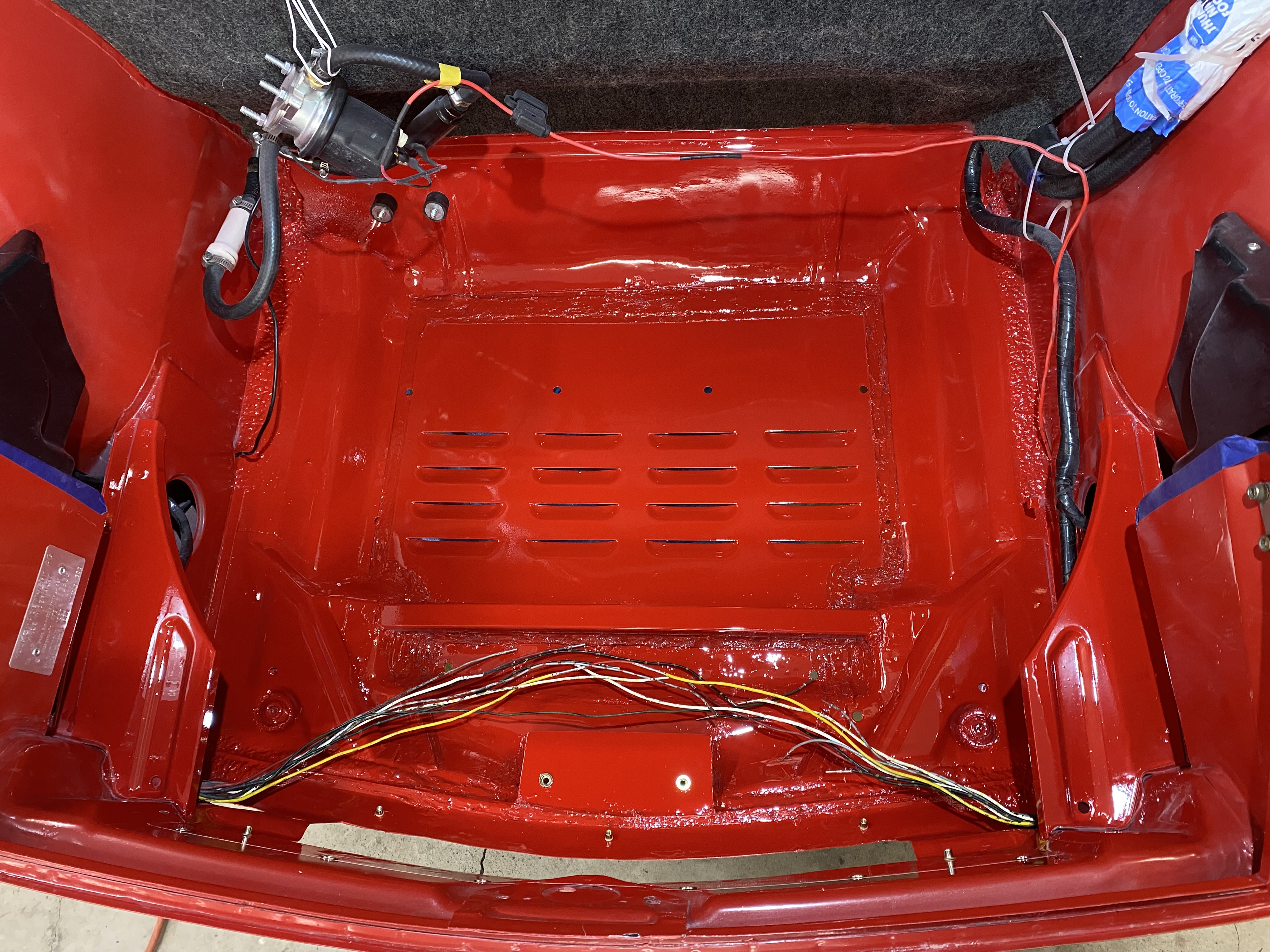

I had to replace the frunk vent pan (Patrick Motorsports sourced) and add some reinforcement d/t cutting up the front air duct opening. Way more work than I thought!

QUOTE(roundtwo @ Feb 19 2026, 12:37 PM) *
Hello,
I don't know the source of this front bumper. It was made with the fog light grills
deleted. I like the look.
I does have the bumper and top made as a single piece.
My point in replying is to advise you that these may or may not have mounting
brackets attached by the manufacturer.
If available get a bumper with brackets attached. You don't want to do it yourself.
More pics of your project please !
flxzcat
post Feb 19 2026, 02:33 PM
Posts: 98
Joined: 13-June 11
From: Lake Forest, So. Cal.
Member No.: 13,188
I bought a front bumper from AIR as shown and a rear. The quality is suffering these days. Too much re-work. I returned both items. Getty quality seems best but not sure they have the part you are looking for. GT Racing may have a decent version as well.
