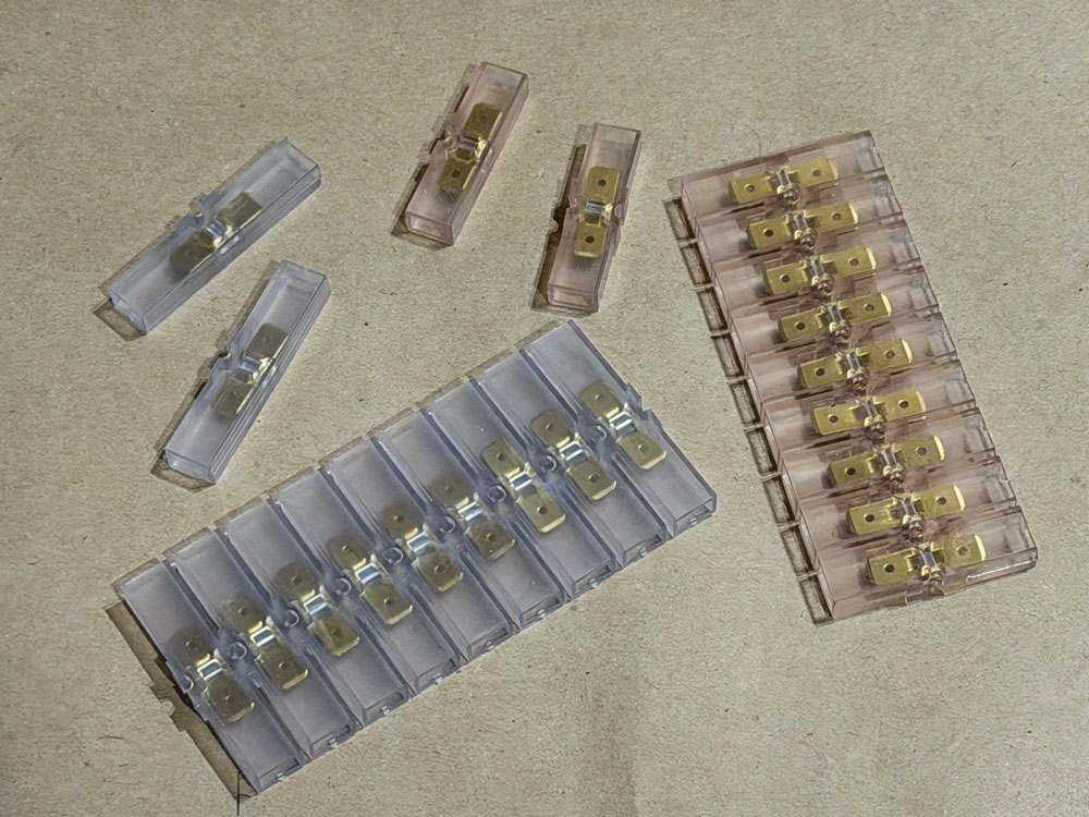

There are a few of these in various locations around the car, two triples up front by the headlight motors...
I did have a bit of a hard time finding them here at first, I finally bought some in Germany via eBay... Then later I did find some suppliers here, but what I already bought in DE is probably a lifetime supply.
I like the fully transparent ones because you can see the condition of the connectors inside. You can cut the 12x strips apart into singles, doubles etc.
