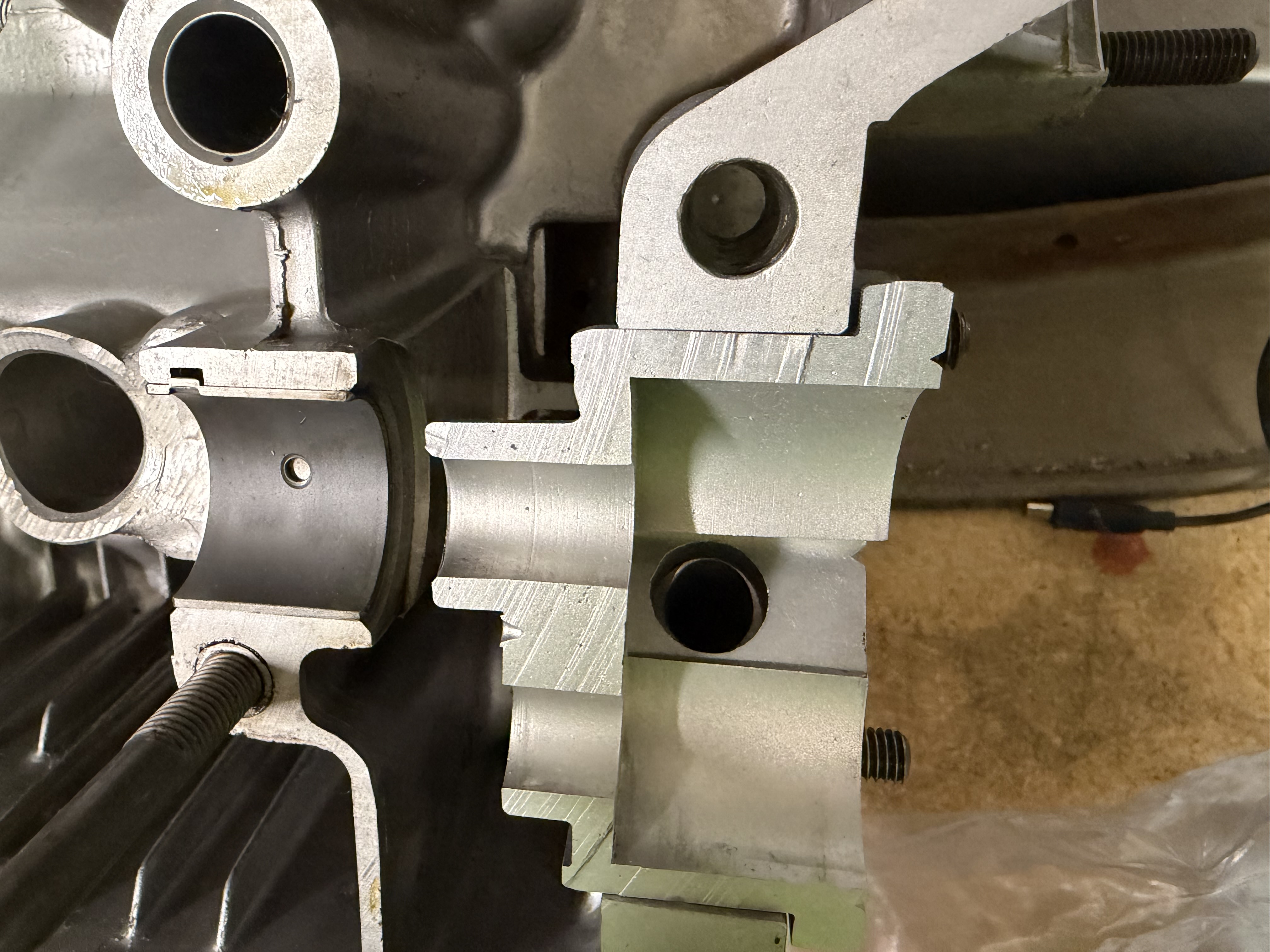

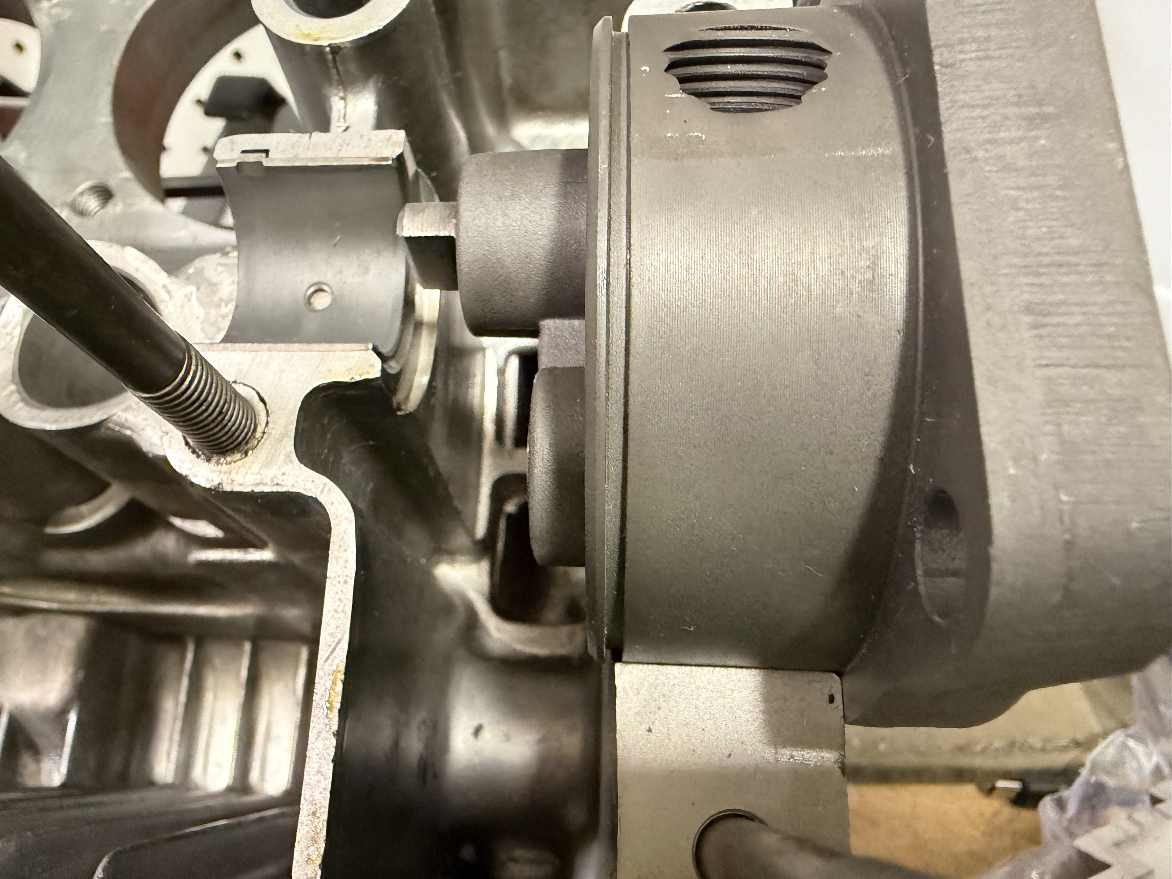

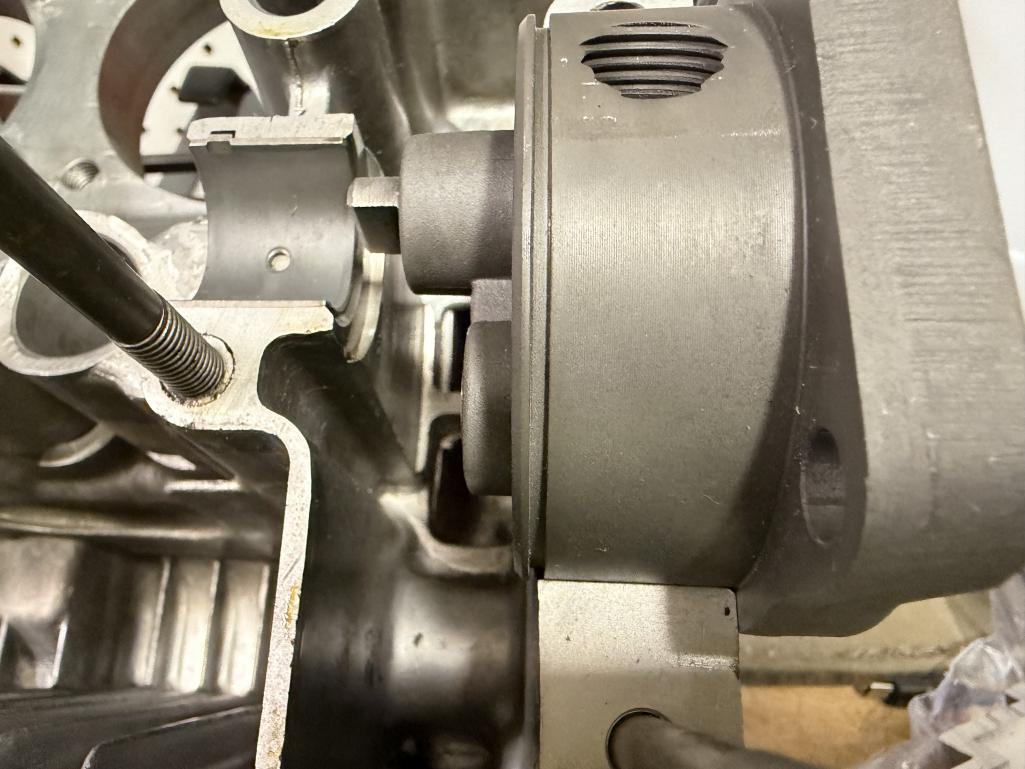

I purchased one from low budget VW and it had the correct circumference, but sat too deep into the type 4 case. It bottomed out against the cam, and the o-ring groove was inside the case instead of the case bore ( Pic 1,2). So I dropped the idea of the o-ring pump and just ordered a CB performance pump built for the type 4 engine. I once again measured the circumference against the case and it was good. But, after looking at it closely in the case I noticed that the oil intake once again didn’t line up properly, and it only had a pubic hair’s worth of metal riding on the case. It was sure to suck air, even though it was the correct circumference (Pic 3).

No the CB performance one is not an o-ringed pump. It fits well in every respect via circumference and depth with the camshaft, but the oil inlet and exit do not. They sit too far back into the case and barely are sealed due to it having such a small sealing surface.

If you look at picture #3, you can see what I’m saying about the sealing surface issue. There is barely any metal on the case covering the oil intake port. I think it’s just a design flaw of the type 1 pump in the type 4 case. I don’t think a spacer would work for that pump specifically because everything else lines up perfectly on the CB performance pump. The circumference is correct, as well as the depth of the pump body to the camshaft. If a spacer was used, I don’t know if it would still engage the camshaft drive gear correctly. It might, but I haven’t investigated it specifically. The spacer worked so well on the Low Budget VW pump because it sat too deep in the depth of the o-ring, the body depth into the camshaft, as well as the drive gear. So the spacer fixed all three problems at once.

Photo shows a cut-in-half old Type 1 oil pump housing. You can see how it fits in this Type IV "W" case, including the area where the oil pump/case oil passages align with each other.

Photo shows a Type I oil pump with o-ring modified for a full flow system and use in a Type 1 motor (Gene Berg pump).
Shown here for illustration purposes only about how this Type 1 oil pump and o-ring fits in a Type IV "W" case. You'll note that the o-ring lines up just inside the case bore, which means a spacer (like the one water jetted by @Chad911SC for his project motor) might be needed to put the o-ring a little deeper into the case bore. It also shows how important it is to mock up your motor during the build process. Especially important when modifying things like using a modified Type 1 oil pump in a Type IV motor.
