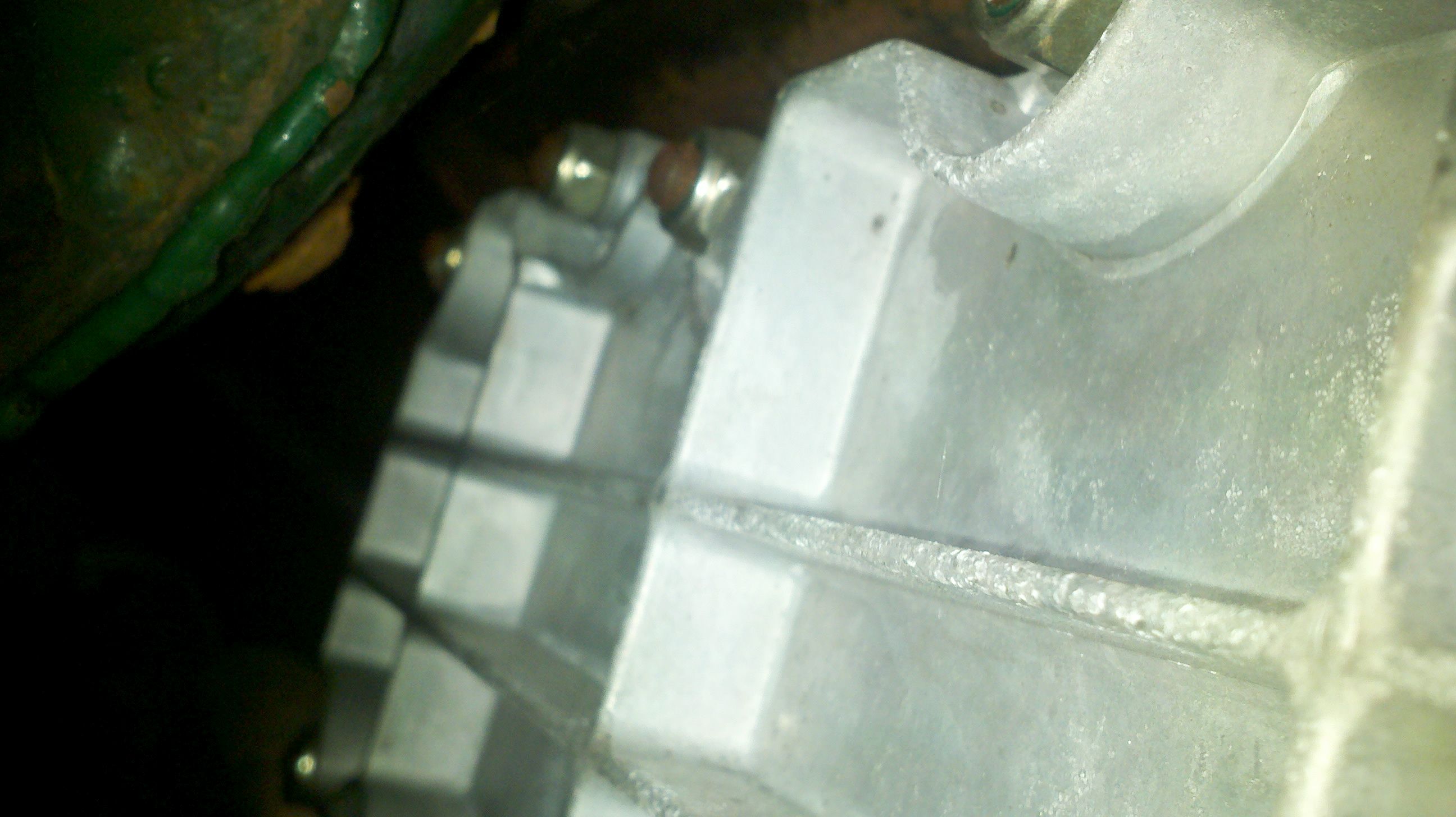

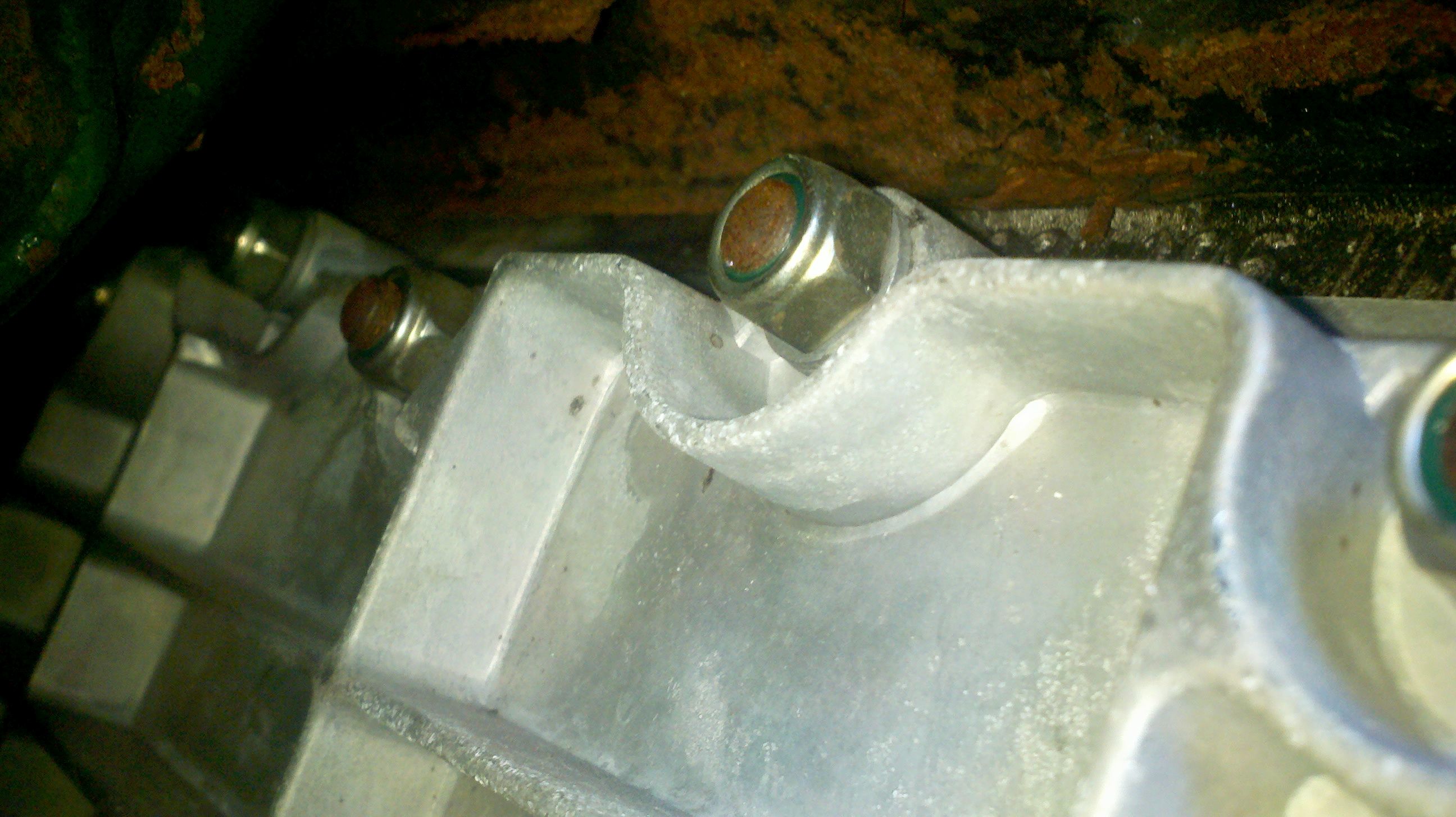

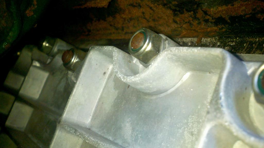

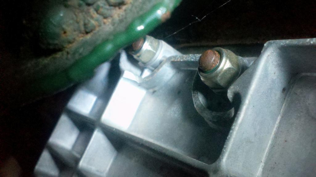

Don't need to take off very much. Took these pictures AFTER I got them fitted, replaced covers with engine in the car.
first 2 are left side, next 2 right side.

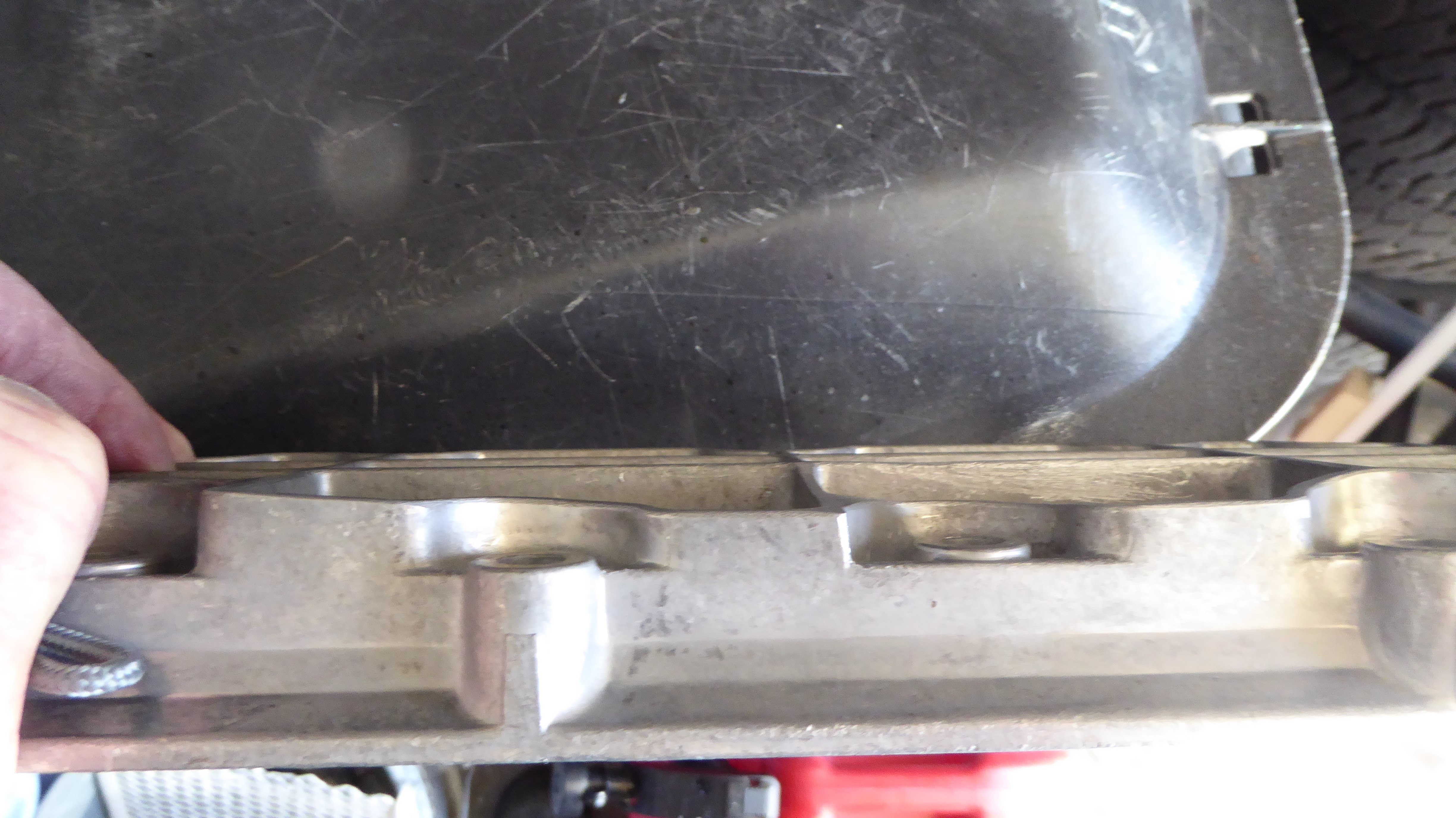

Remove as little as possible to retain strength, I used a surface grinder with a Harbor Freight flapper disk . fit as you go with the engine in the car, actually goes pretty fast.Attached Image
