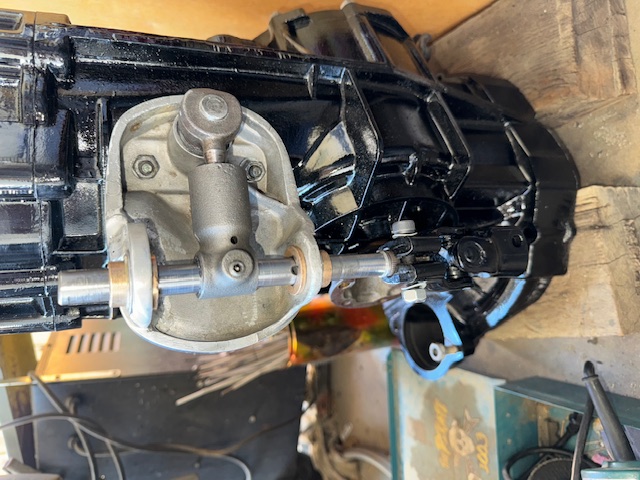

The stock bushes aren't a great fit ,reason being they have to be under size O.D. just to fit in their locations ,the Tangerine bulkhead and the console bush cover that issue , the slop is then gone , the Tangerine complete system is next ($$$) level IMO.
It wasn't practical for me to import so I built my own one, used buggy supply sealed uni's front and rear and fabbed the holder for the second rear bronze bush as a secure bolt on to the original console.
The end result is a notchy nice positive feel when shifting ,you really know you are in the gear you selected if set up well .
You can use the stock shifter ball bush ,Tangerine bulkhead bush and the bronze rear one you will be well pleased, cheers.
Saved money and had a blast building it. I just used steering parts for my parts car, had the shaft inside the steering column turned down to use for the shift console rod.
