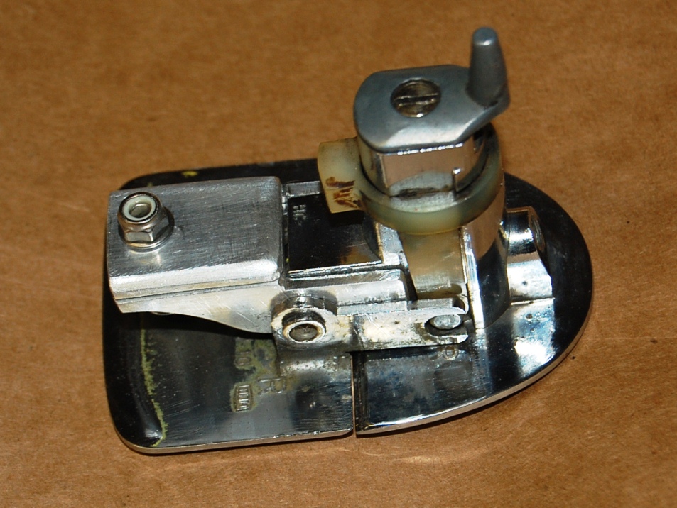

My Driver's side exterior door handle is shot and trying to source a replacement without having to buy with a new lock cylinder (would like to stay to a single key).
I've tried one from 914Rubber and Sierra Madre collection. Neither one worked due to the fact the hole for the lock cylinder is too small. Did a quick search here and saw a comment not to buy the reproduction handles for that reason. I've also looked some on eBay and all the used ones are broken or are the repos.
I thought a saw one that no longer used the lock cylinder and converted to a push button, but can't seem to find that now.
Has anyone had luck with ordering a new door handle recently?
TIA.

QUOTE(75ninefourteen @ Mar 5 2026, 02:12 PM) *
TIA.
Hi. Please contact me at 914locks@gmail(dot)com
My handles will fit. I have both used and newly chromed
Curt

Refurbished by Curt or new from Porsche, at least if you want the lock to actually work. All the new aftermarket handles (that come from the same source no matter the vendor) have issues with the lock cylinder fitment.

This is why I need a new handle.

Gotta keep everything lubed up or the flap breaks off when you pull really hard.

The mounting tab can be fixed if broken.
