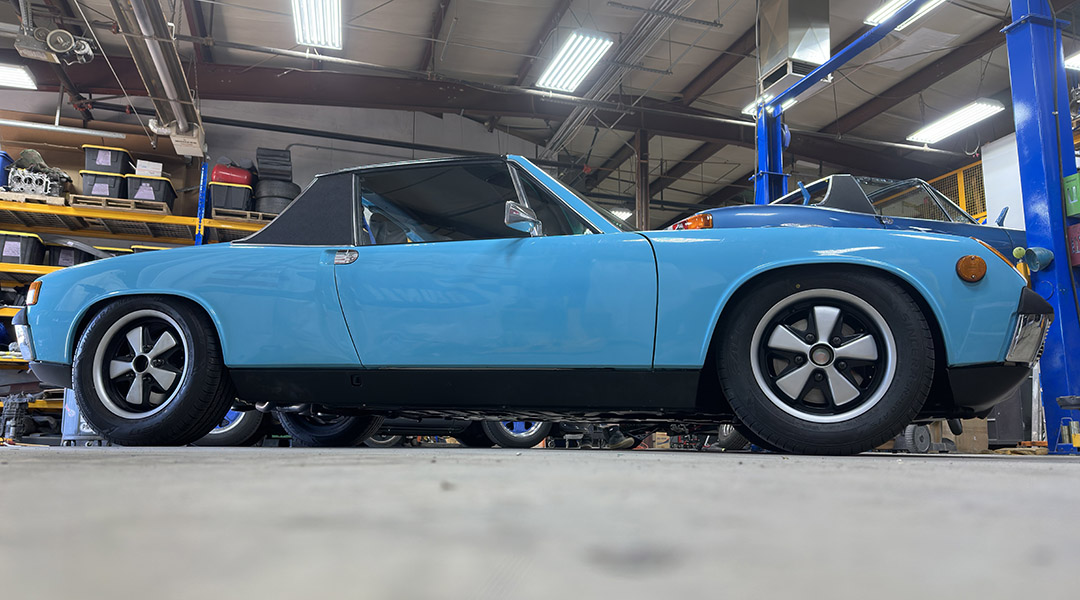

I believe Eric Shea (PBM) has done some builds using the 15 x 7 RSR Maxilite in the back on narrow bodies. Their offset doesn't require any mods or slightly (?) to the wheel arch. These would be deep six look.

Don’t count on 7’s to fit the back. They might, but usually don’t. Especially with any reasonably sized tire.
If you are willing to pull and/or roll your fenders, then they may fit ok.

Mark Sonners 2270 with deep 7s in back and front in deep 6s
looks great and no scraping in back. Picture at PMB The finish on wheels is very nice
