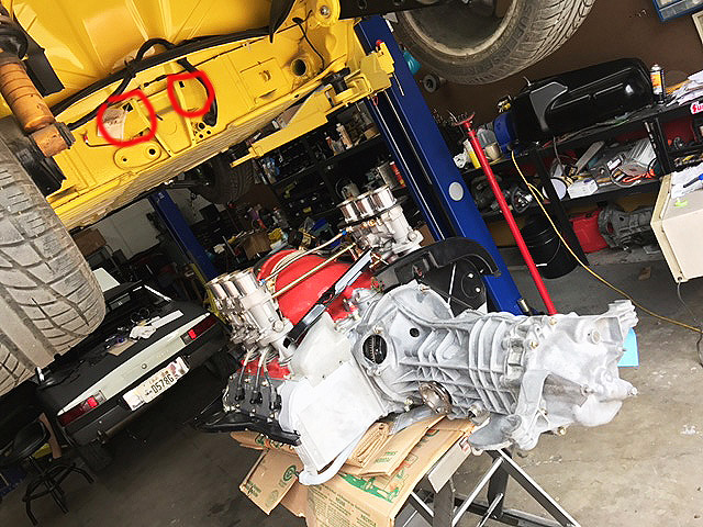

post Mar 9 2026, 01:30 PM
Posts: 3,975
Shown, factory 6 mount on car side with GT Strengthening on mount. Circled in red

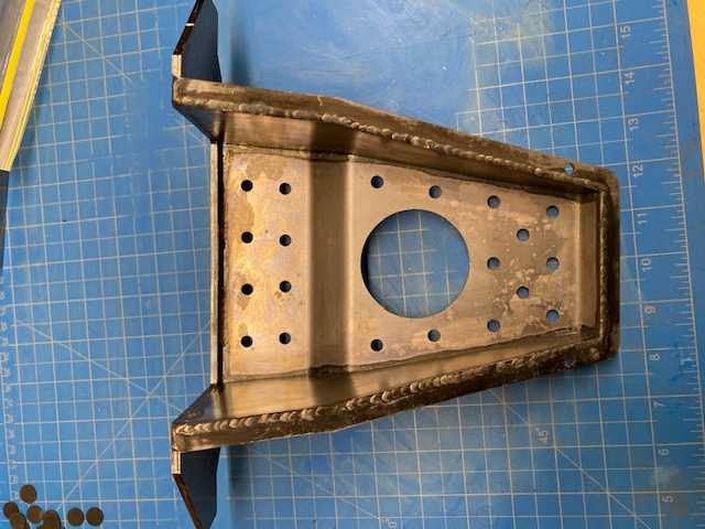

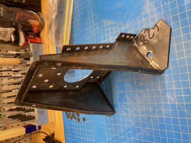

Auto Atlanta sells the Mittelmotor version - which might be the closest re-pop version:
https://www.autoatlanta.com/Porsche-Factory...PN-RMM305A.html
I have just the chassis mount side that I bought directly from Mittelmotor that is raw steel (no primer) that I am looking to sell for $230 + ship. This mount it definitely beefier than the factory mount - weighs 1205 grams
