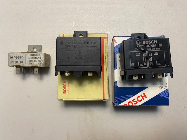

It's a good sign you're hearing the fuel pump with the flap held open. Sounds like the pump is working, although fuel pressure remains to be determined. It is amazing how well these old pumps hold up. Mine is still working as well. A replacement sits on the shelf waiting for the inevitable.
The dual relay in my '75 1.8 is mounted on the bottom of the battery tray, on the driver's side of the tray. Yours is probably in the same place, or somewhere nearby. Here's a picture of what you're looking for. The original dual relay is a silver metal box, part number 0332514102, the next generation is a black plastic box, part number 0332514120, and the latest generation is also a black plastic box, part number F026T00064.

This is great and I was able to locate the silver box below the battery tray so it's probably the original. I will order one of these dual relays and try it out or at least have one as a backup. Thanks for the stock numbers and photos!

Yeah, if you still have the original metal relay I'd for sure have a back-up available. These have become $$, although at least they are available again. For a while they were NLA and some people were asking $450 for them, and some people were actually paying that. You can get one from Jbugs. It will be listed for a 75-79 Beetle. Here's a link:
https://www.jbugs.com/product/071906059.html
If you aren't in a rush then order it from Cars245.com. Search for it by the most recent part number. They ship from Latvia and it will be about $30 less, including shipping. However you run the risk of being caught up in this nonsensical game of WTF tariff nonsense. Currently 10% from Latvia, but tomorrow who knows? Shipping takes about 2-3 weeks. They also sell them on eBay but ordering from them directly is cheaper.
I think it's a good idea to have a back up, but I'd make sure your current relay is defective before rushing to get one. If it turns out to be bad and you have issues getting a new one just send me a PM and we'll work something out. I ran a group buy a while back and have an extra spare that I've been hanging on to in case a fellow member gets into a tight spot. I also have two used relays that I haven't tested yet, and an NOS relay that just came my way.

I had this happen to my 74 1.8L recently. My original dual relay went out. I put in another known good used oem metal dual relay and my 914 roared back to life. I now have a few of the newer plastic dual relays set aside ready to go along with a few afms. I've started to collect anything related to the FI system for these cars. I also recently replaced both the FI harness and ignition harness made by Jeff Bowlsby to replace my 50+ year old harness. All if not 99% of my electrical gremlins disappeared related to the FI system etc.
