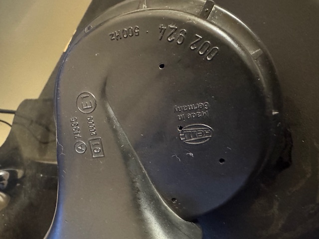

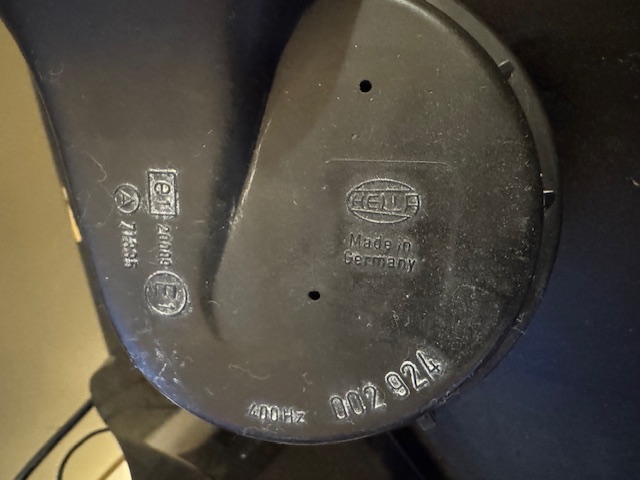

post Mar 27 2026, 06:01 AM
Posts: 3,333
After two people made left turns in front of me I asked for a set of loud Hella horns.
This was what I got, 400hz - 500hz. Easy install. Did I mention they are loud:
