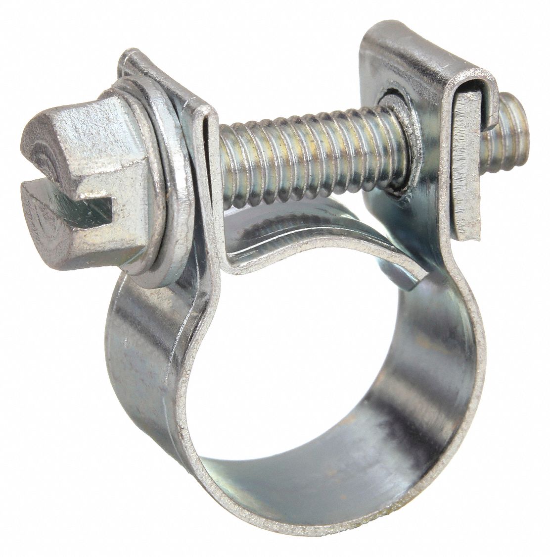

For clamps, I’m planning to use Porsche/Würth Zebra clamps
https://sierramadrecollection.com/products/...x-drive-5391016
Unless there’s a better option I should consider.

Wait for the J tube. Use Band clamps, NOT gear clamps.

(IMG:style_emoticons/default/agree.gif) Use the correct fuel clamps, not the gear clamps. I see them at my local flaps but Tangerine carries all the fuel system parts as well.
