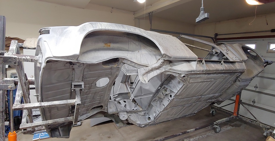

QUOTE(Nein For Teens @ Apr 8 2026, 09:49 PM) *
Hi Everyone.
A year or so back, I bought a trailing arm installation kit from 914 Rubber (formerly offered by Middlemotor, llc). They still offer it: https://914rubber.com/trailing-arm-suspension-gusset-set. The kits (one per side) did not come with any installation instructions. Try as I might, I cannot figure out how the pieces go together, nor can I find any help online. Has anyone installed/welded this these on? I called 914 Rubber, but while they are usually super helpful, they could not offer any insights on this particular product.
Thanks, Chris
Hi Chris,
I installed that same kit in my brothers 914. You have to place them up against the mounting area and form them to fit. What I did was figure out which plate went where then tack welded them into place. I used a big hammer and formed them to the chassis, welded them up and ground welds. It's a pain to install them if your on your back. I had my brothers car on a rotisserie which helped. I know that RD now makes a copy of the factory ones which will be way easier to install.
This is the only picture that I have of the kit installed.
