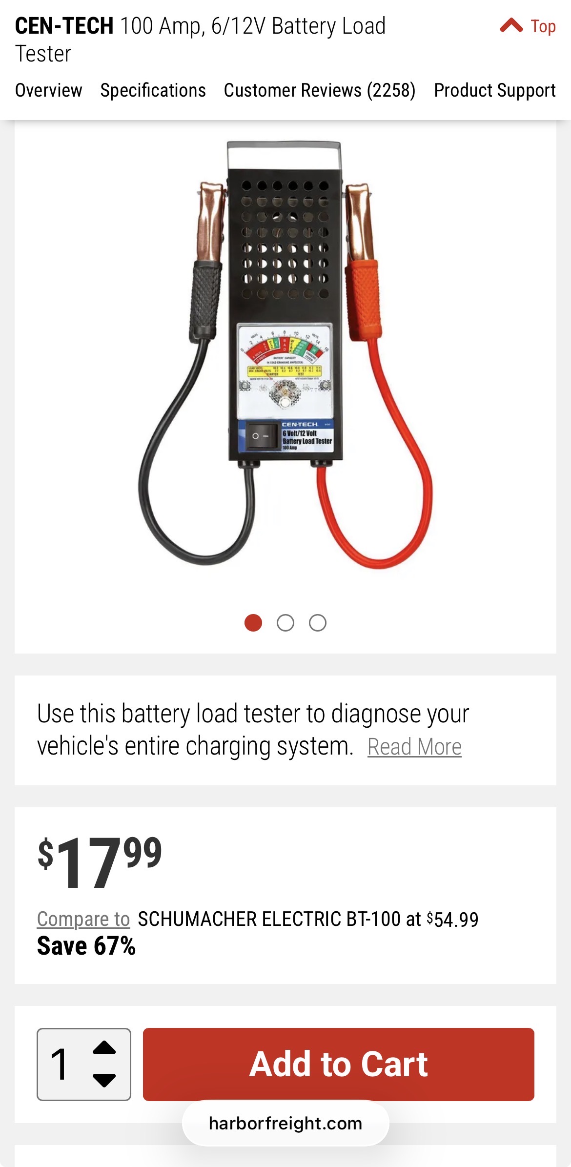

Spend $20 on one of these before you do a $300 battery. I probably use mine about once a year on my mini fleet. Very basic old school but works and you control it and can see what is happening to voltage as 100A load is applied.
To test the battery cables you need to measure voltage drop across the cables while attempting to crank. You need the current draw through the battery cables to measure the voltage drop. It’s either a two person job or need a remote start switch.
Anything more than a 0.1v drop across a battery cable while attempting to crank is too much and indicates bad connection. There are ways to narrow this testing down to know whether the loss is in the wire or at either end termination.
