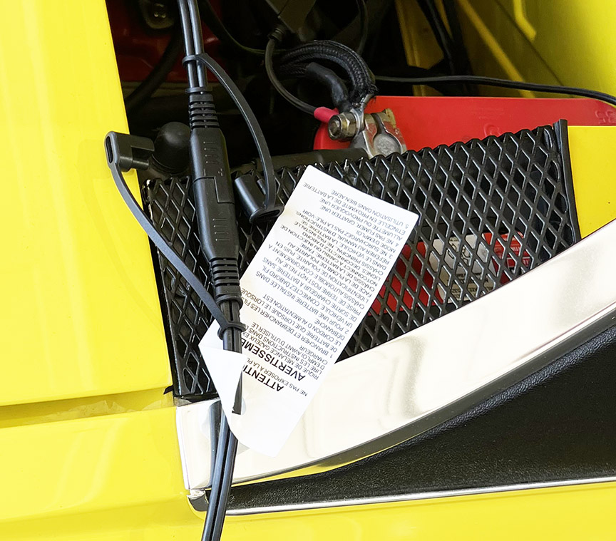

Battery hook up PMB way
Best Bob BAttached Image
