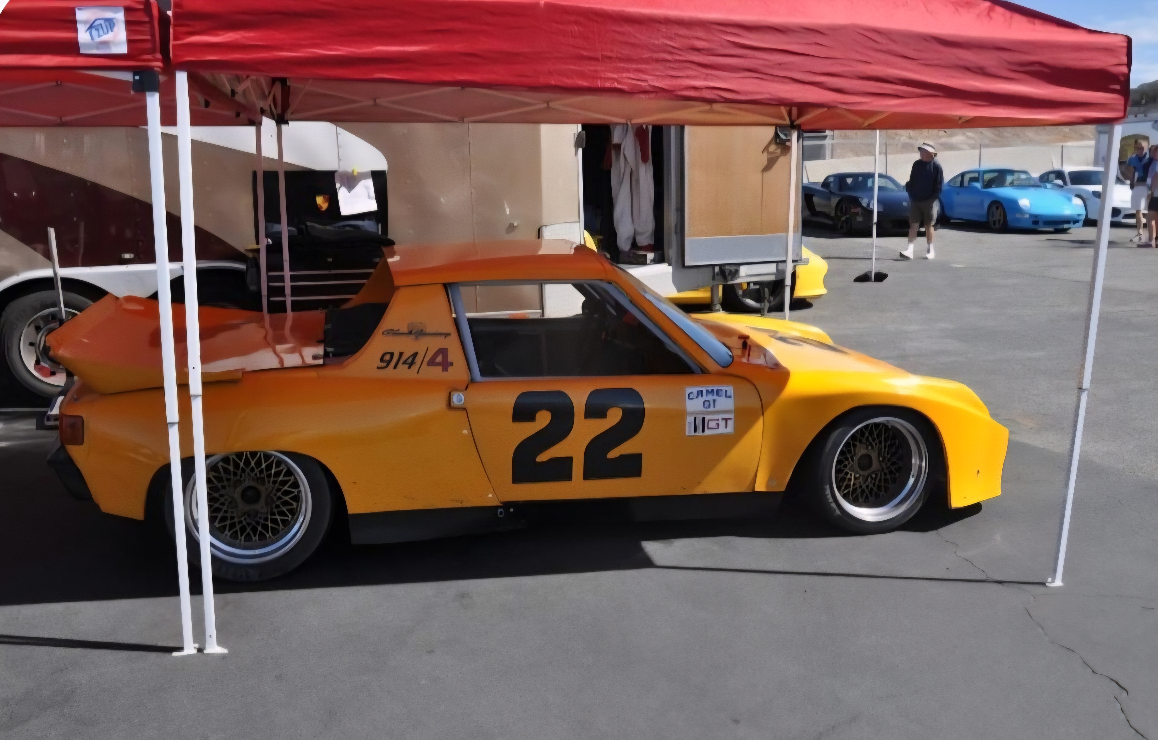

Good friend of ours Tom L. from Santa Fe NM, is the new Steward of the famed Yellow School Bus (IMG:style_emoticons/default/aktion035.gif)
Originally built in 1979/ raced by Wayne Baker in the '80s ; Wayne then took the wheel of his IMSA 934...and the 'Bus sat, sold off, somewhat raced then stored.

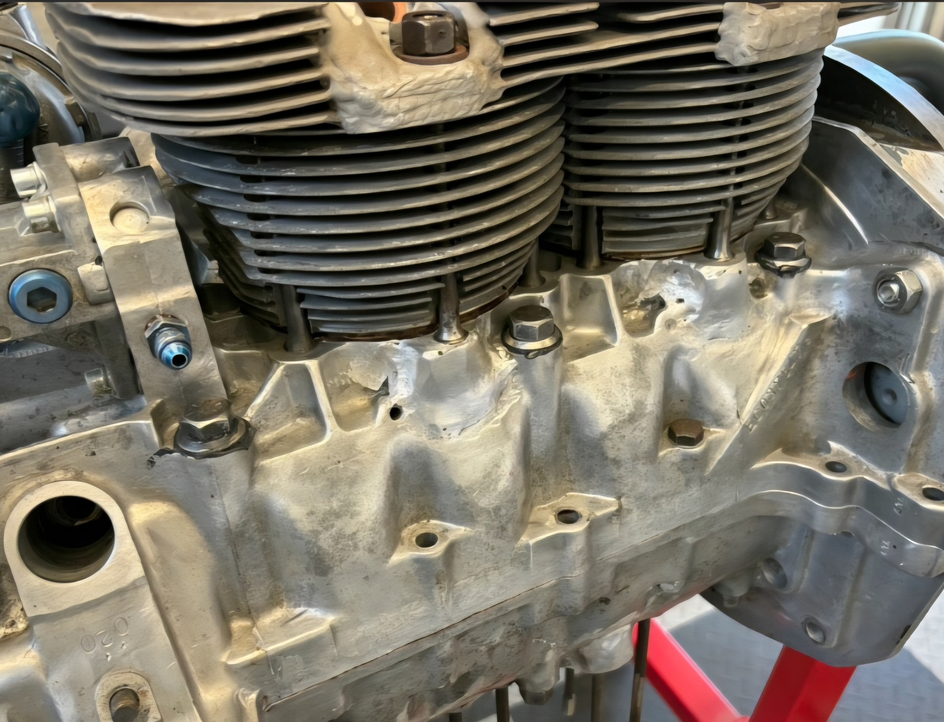

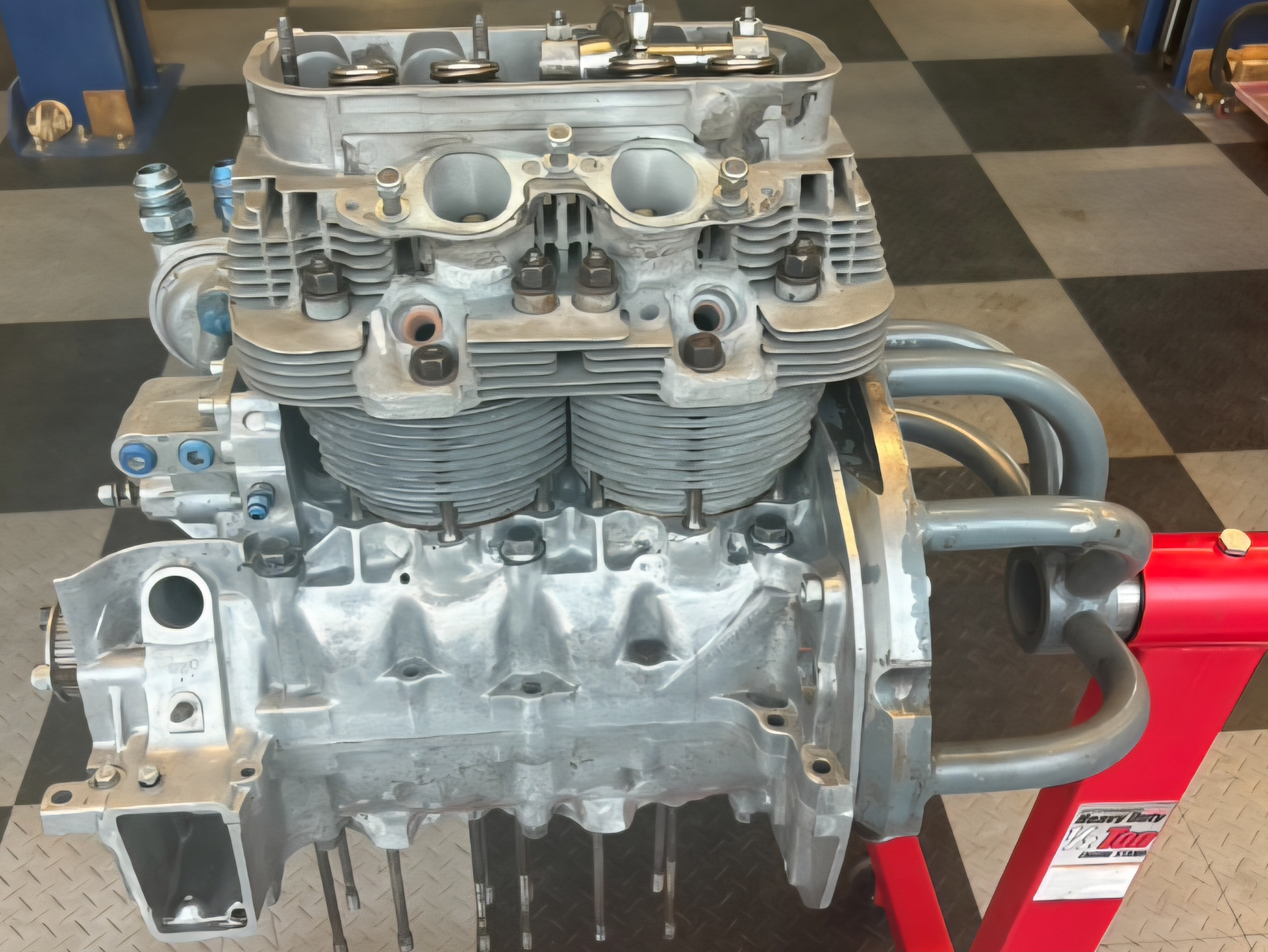

It is a highly tweaked T4 2.2L custom engineered 6-stud heads, BMW mfi (2002tii) in a 1,650 lb 914.
Some pics to follow, and he's waiting on the rebuilt heads from Pauter; might make Sonoma this month ¿¿

Pic by Mark M./ Laguna Seca

Engine makes approx 220 bhp

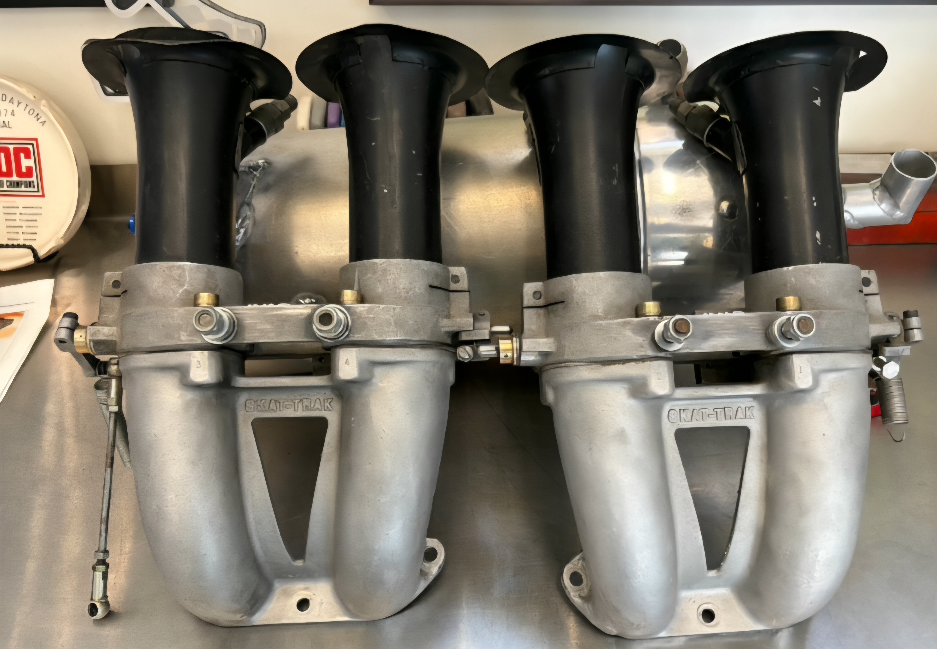

MFI from 2002tii
The alternator drives off of the Right rear axle.

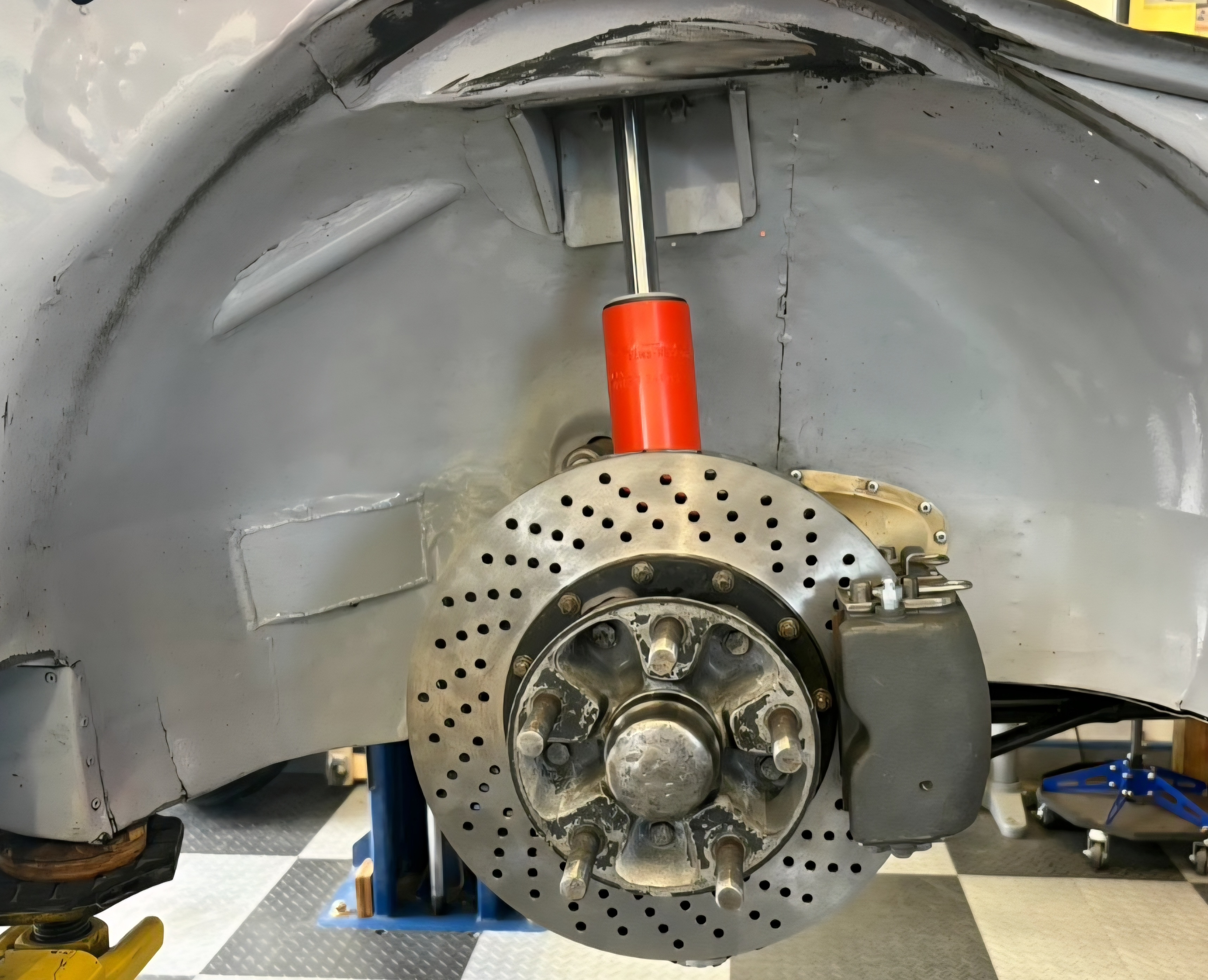

Front calipers are AP brand, similar use on the Ford GT-40

Cool 914 with some cool history. That engine is beyond cool!

Coool Injection! (IMG:style_emoticons/default/drooley.gif)

Kinsler/Hilborn or similar on the manifold shot.
Probably the MFI pump made by Kugelfischer that was from BMW 2002tii
I've driven a bunch of old race cars, and those AP Racing calipers were the stiffest aluminum 4-piston types available. <5lbs each with pads.
