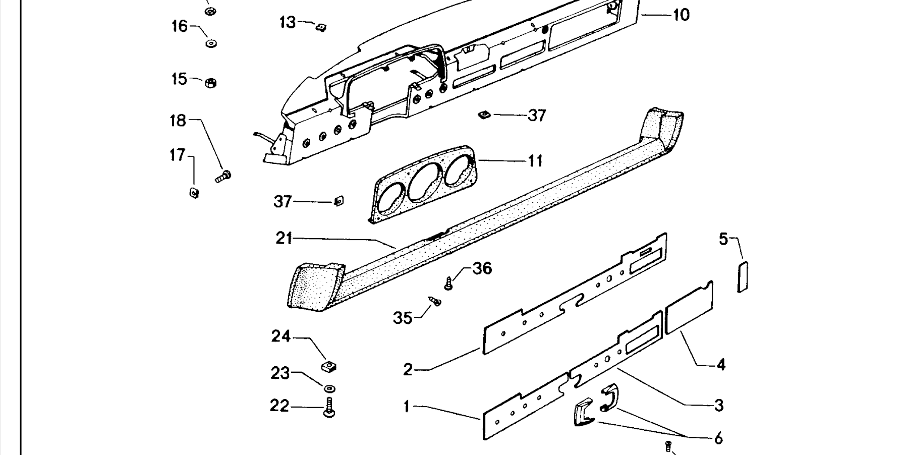

So like an idiot, I have lost some parts and now need to get replacements. I know I put them in a safe place so I wouldn't lose them, but where that is is a mystery.
I removed the lower dash knee pad. I have the 5 bolts which secure the bottom. What I can't find are the 2 screws and covers which go on the ends by the vents.
I would like part numbers and possibly any information that would be helpful. I've looked in the PET, but couldn't figure out which they were.

IIRC, they are Phillips head sheet metal screws… Not sure of the size, maybe 4.2mm probably around 10-12mm long…

Did you look in the PDF parts catalog? Maybe #36 qty 2?
900 143 066 02 Oval-head sheetmetal screw -71 B 4,2 X 9,5
900 143 070 02 Oval-head sheetmetal screw 72- B 4,2 X 13
