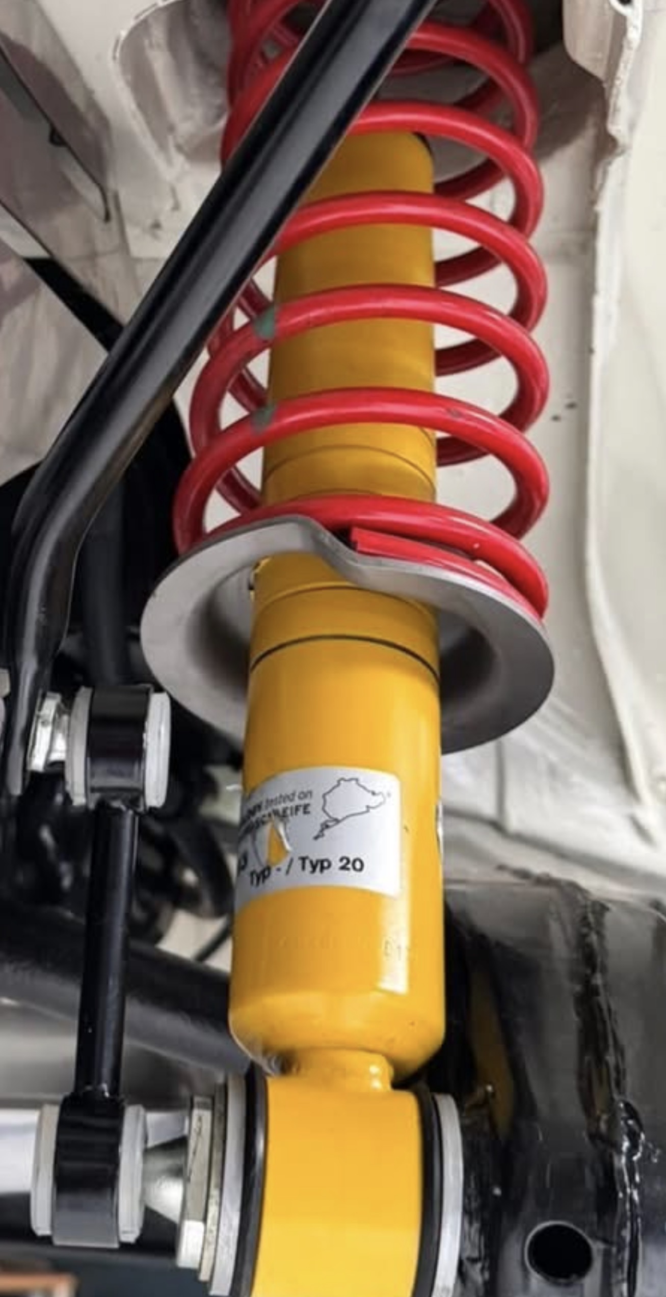

Borrowed pic from other member.
You can see the clip for the groove to hold the perch.

QUOTE(ndfrigi @ May 21 2026, 11:18 AM) *
Great! Looks like set at 3 above the bottom. Others have set at 4-5 above (see earlier postings). (IMG:style_emoticons/default/biggrin.gif)
