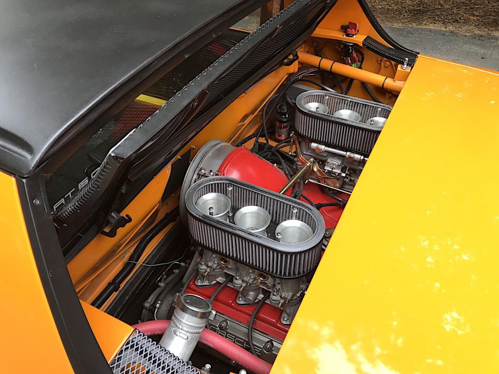

Same story, pump and filter up front, single SS line then rubber hose to fuel regulator , addition filters to 40 PMDs, five years running great on a 2.2L S with Mod-solex cams.Attached Image
