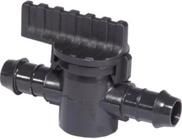

I've been thinking about a substitute AAR valve for awhile now, let me run this by you.
The factory AAR is a simple electrically-operated valve varying from fully open when the engine is cold, to fully-closed when warm. The electrical heater in the valve conveniently and immediately begins to close the valve, and the heater is on full-time the engine is operating, keeping the valve closed. No wonder they fail electrically. And crud accumulates in the valve causing the valve to stick, requiring maintenance.
Anyone ever considered a manual valve as at least a temporary workaround? Both AAR hoses are 12mm ID. My idea is to use a plastic drip irrigation, header, inline ball shutoff valve with barbed ends. The valves are available with 1/2" OD ends, which should be Plug N Play with the existing hoses. Besides it looking like a hack, an inconvenience is that one needs to operate the valve - open it to start the car, then close it a couple minutes later. Rinse/repeat. Inexpensive, and technically it should work, but I have not tried it.

QUOTE(JeffBowlsby @ May 27 2026, 08:32 AM) *
I have had this on mine for years. I use it for troubleshooting. During the cold days I will use it when my aar takes forever to close. I find after the car is a little warm the computer can compensate just fine by richening the mix. Really only need the aar for the first cold start and if you let it warm up a little you can just close it and go on your way. Just don't open it full, that's way too much air.
