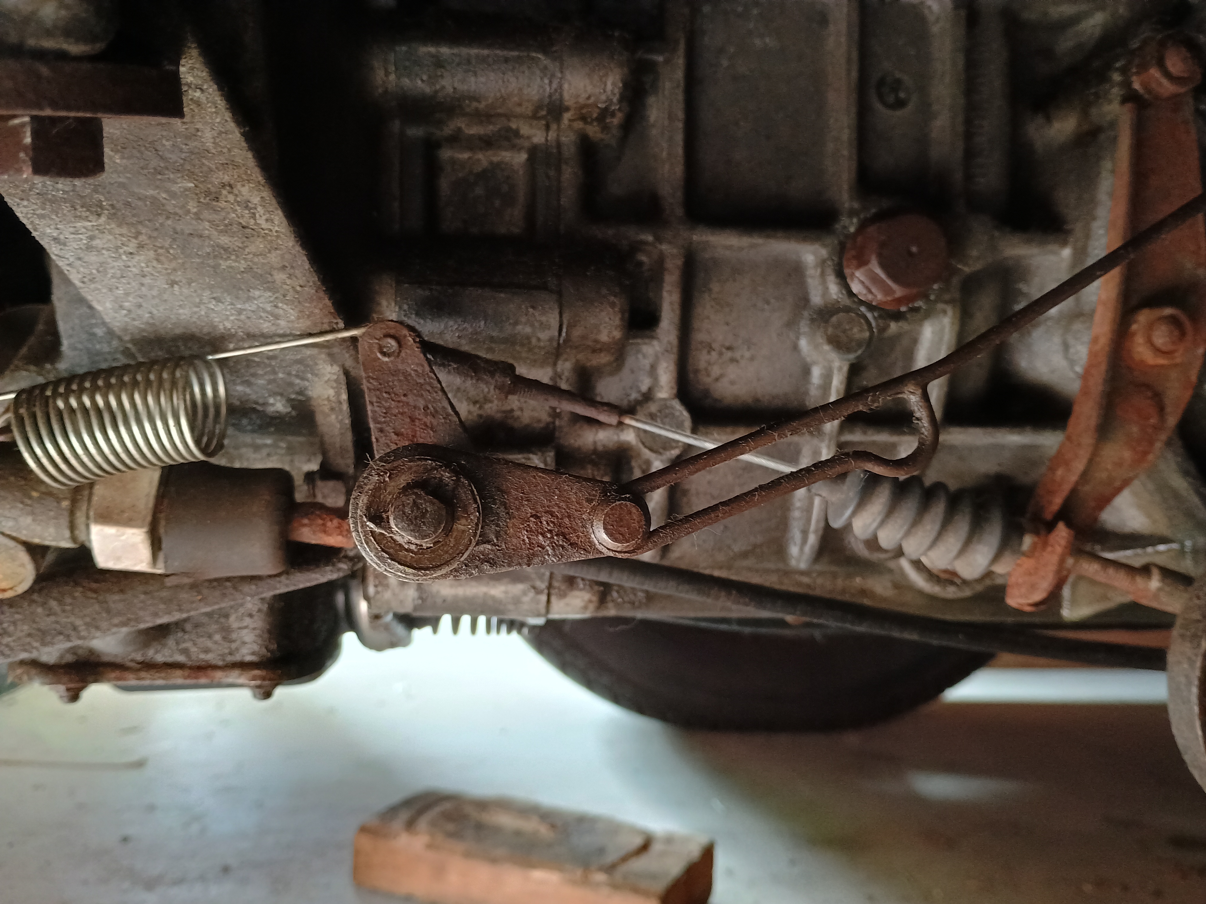

post May 31 2026, 09:44 AM
Posts: 20,722
The one in the first pic is 911
fixer34
post May 31 2026, 02:24 PM
Posts: 1,438
Joined: 16-September 14
From: Chicago area
Member No.: 17,908
Original as far as I know.. (except for the big-ass return spring..)

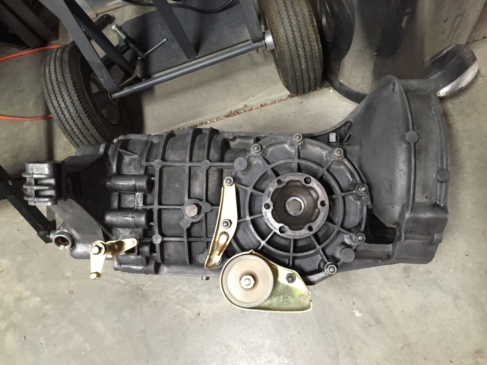

Retroracer
post May 31 2026, 02:46 PM
Posts: 659
Joined: 7-July 13
From: Bend OR
Member No.: 16,100
Another one. Seller claimed this was 914/6 and was in a box with other 914/6 stuff:
Works a treat. Angles work well with the matching throttle cable termination and the "coat hanger" rod going up to the carbs.
