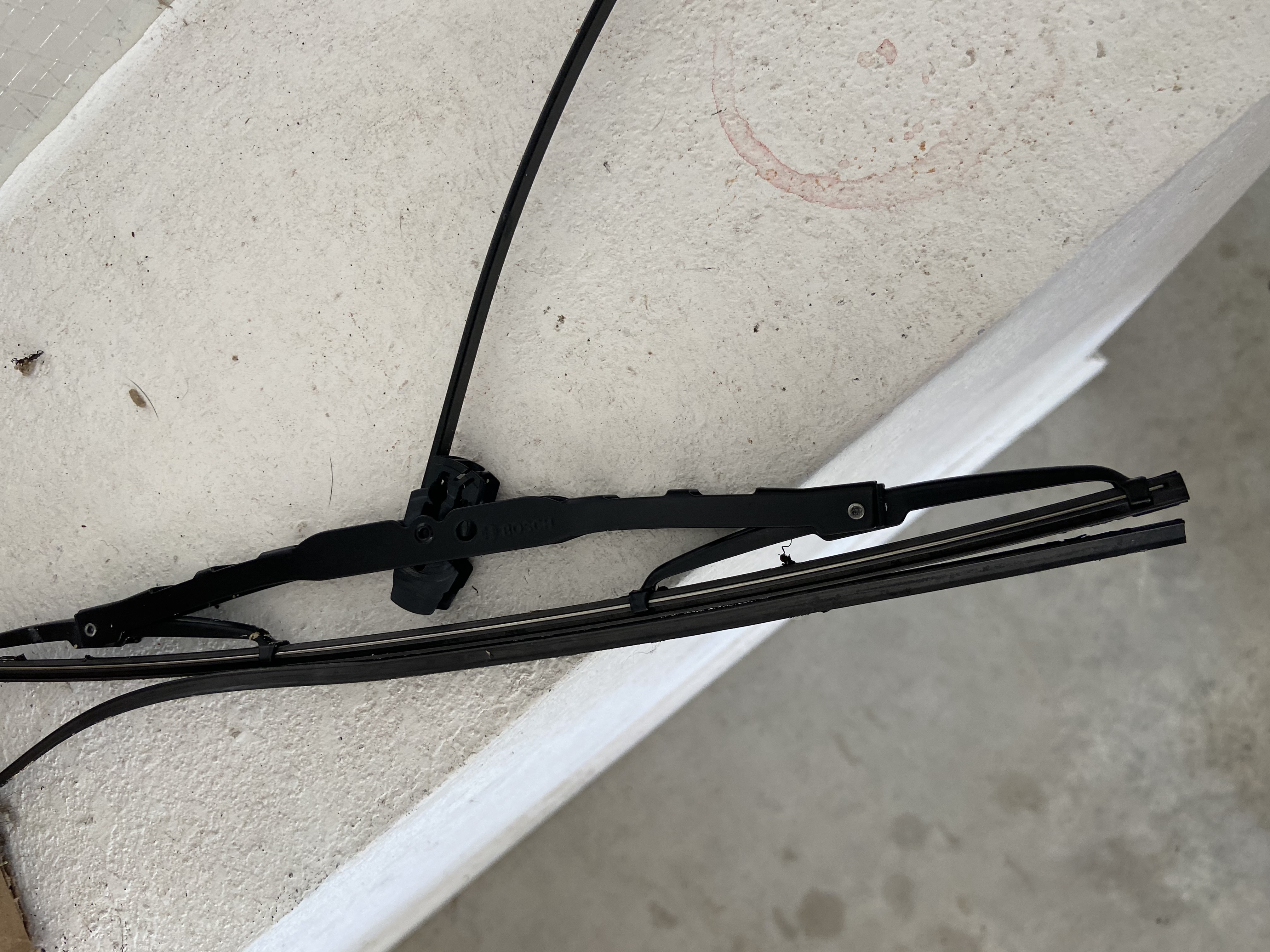

I just noticed that my wiper rubber is torn on one blade.
Question #1 how do I remove the blade?
Is there an insert I need to pry out with a screwdriver?

The last time I put a set of wiper blades on my 74, I installed Bosch 13" blades. The current part number is C1301 via Oreillys. The blades are very simple to remove. Just depress the little latch on the blade assembly and it should slide right off the arm. The wiper arms are a typical U-hook design.

Make sure the blades are for 7mm arm NOT 9mm.

Or save the 7mm connector from the current set and reuse into new set.

I know I am being thick headed, but I still am struggling to take the blade off the arm.
Can anyone solve where is the latch to release?
