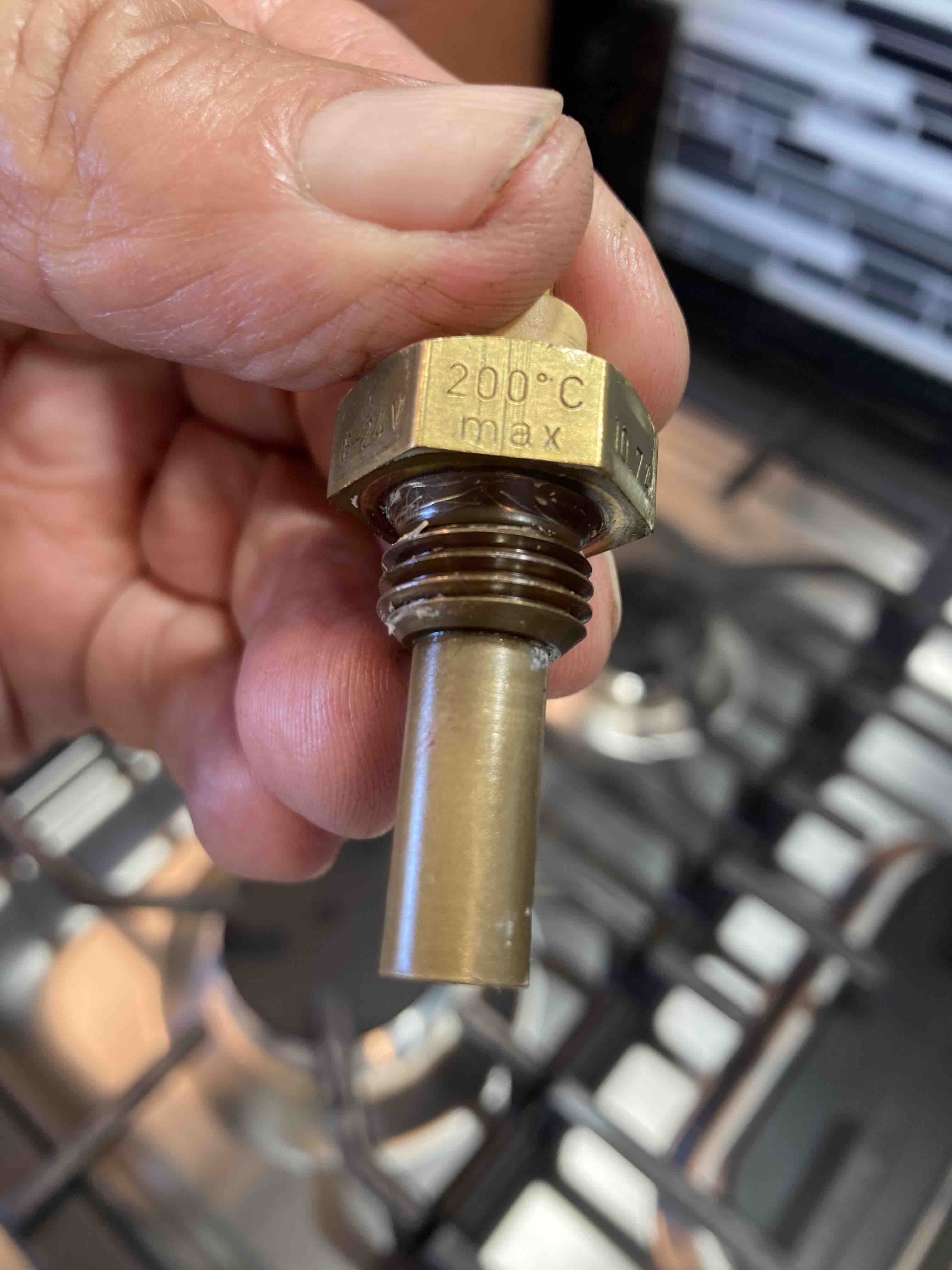

I have a unreliable Fatory oil temperature gauge I want to replace .
Looking for a good working or NOS VDO 60mm center console oil temperature gauge .
I have the 200C sender so I need the one in photo

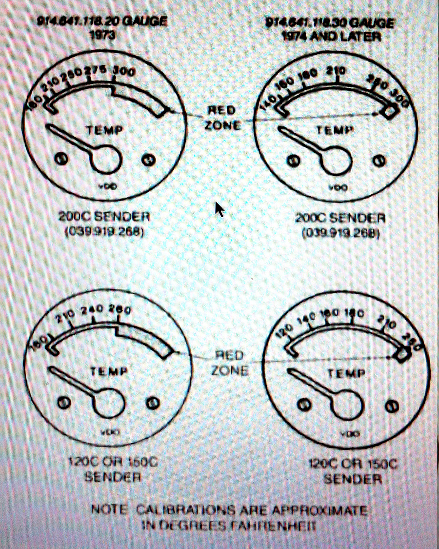

Looks like a 74-76?
https://web.archive.org/web/20170805001317/..._console-74.htm
You can use any one with your sender, you just need to know how to read it...your face markings indicate those are for the 120/150C sender.

It is a 76 with the 200C sender . I have already pulled it and verified this . I know that's what it looks like though but it's not. If I could post a video (learning to post a photo was enough for me ) I could show you that the gauge needle moves to about the 210 degree
mark as soon as I turn on the key . I think the gauge is bad . Once I locate a good one I will post my results . Thanks for comments , I appreciate all comments from the world .
