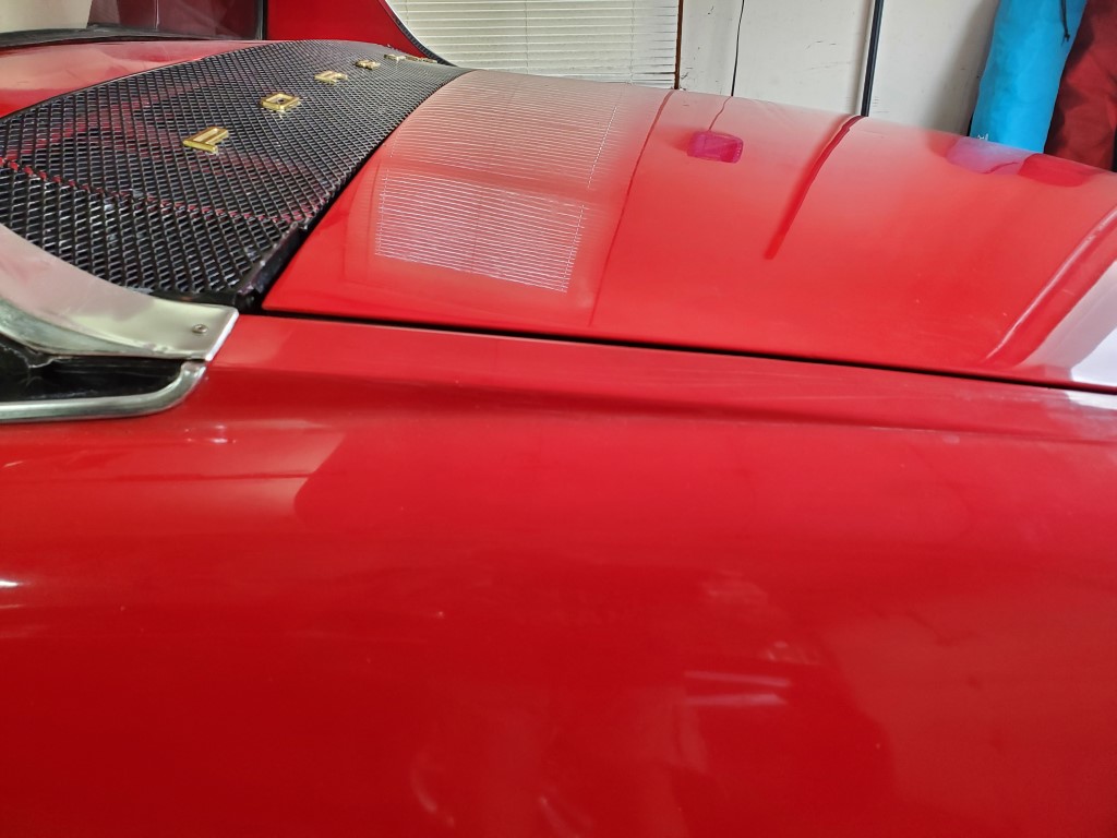

I had to do my passenger side about a year ago when I bought my car. I created a spring tool from a 10" crescent wrench. Not the 8"... use the 10".
The first time I did it the motor was in the car. My hinge was in the same shape as the one above so I went jwest on it. I managed to get it almost perfect, but it needed to go down and back about 1/4 of an inch. I perfected the install when my motor was out. Holy Cow was that 100xs easier with the motor out. I almost did the driver's side at the same time, but I figured if it ain't broke...
YMMV
When I bought it:
Almost perfect:
Today (after being able to adjust it from 'in' the engine bay:
Hard to tell the difference but it matches the drivers side. One is OEM the other is Jwest.

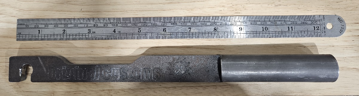

Looks like you need the special tool for the tension rods.
I purchased one of the tools years ago from Mark at Original Customs.
I wouldn't do that job without that tool now. I've done it before just like you are doing now with the wrench and an extension on a deep socket.
I've had that spring snap out of the socket it's not fun and super dangerous.

Try reaching out to Mark. He may have a spare to sell?
Here's what the tool looks like. I have used it 2 times now and works great.
