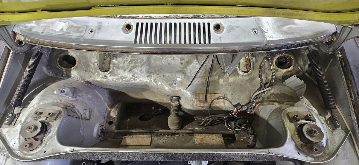

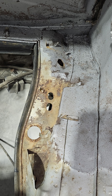

I took a quick look at the 73 2.0 today. The right engine shelve needs to be replaced as there's lots of pin holes and rust there. The hell hole looks ok but I need to really get in there and dig around. Both jack points are bad and the p/o cut them out. Front and rear trunks look good. The floor pans are in pretty great shape minus a few dents from someone jacking the chassis up. The interior is in pretty good shape and just needs a cleanup. The seats will need some work. Each fender and q-panel has an issue so it's a good candidate for a set of steel flares. The good news is the car came with some of new RD metal for the repairs.
The plan for this one is a 6 conversion, 5 lug setup, steel flares, and a paint job back to the org silver paint.
All of the 4 lug stuff is going up for sale, wheels/tires, and anything 2.0 4 engine stuff that's left in the engine bay.

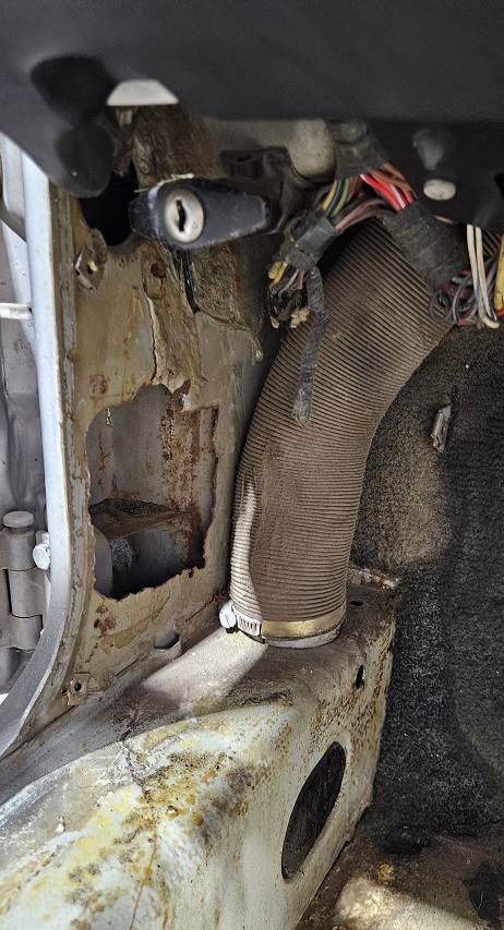

I started cleaning out the interior today. I hate when people butcher the chassis to make things fit. I'd have to take a good pic of what I found today.
I need to check the passenger side to see if it has the same issues.

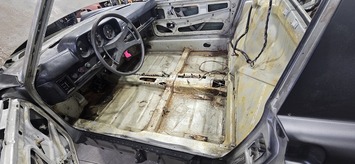

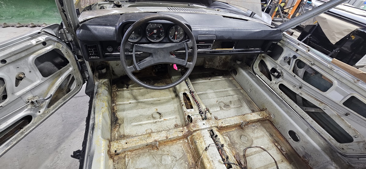

We started the disassembly portion of this build. The interior is about done. The dash and harness needs to be removed yet. I found some sketchy stuff done to the wire harness so that'll have to be addressed. The sound pad/tar paper or whatever it's called now a days needs to be removed from the floor pan. That's a special job set aside for my son to get done. Front trunk is about done too. Fuel tank, fresh air box, and wiper motor is out. Still need to get the headlight assemblies out and move the harness back to the bulkhead for removal. Rear trunk is done. The engine bay is getting there. I have a few more items to remove. I took a look at the hell hole and it needs a little work. The right engine shelve will need to be replaced but that's easy enough to do. I'll see what tomorrows schedule looks like and hopefully get some of these items above taken care of. I also posted a pic behind the speaker grills. Both sides look like this.. (IMG:style_emoticons/default/blink.gif)
I do not know why people butcher cars like this.

Looks like buying a 914 with the sills already cut open is a good way to judge rust problems.

We got the 73 pretty much stripped minus the suspension. We found a few old mice nests while removing the wire harness. Next we will roll it outside and pressure wash the heck out of it. Once that's done it's time to brace it and get it onto the rotisserie. Then the suspension will come off. So far we aren't finding anything major to repair minus the jack points and drivers door post. The headlight buckets, trunk channels, floor pans, and trunk floors all look too darn good to be true. This is a decent chassis for being 53 years old. It must have been a garage kept 914 from what I'm seeing. The wire harness has a few problems and will need some wires replaced thanks to the mice damage... (IMG:style_emoticons/default/chowtime.gif) ....
Time to cleanup the shop and get parts labeled and into bins.
