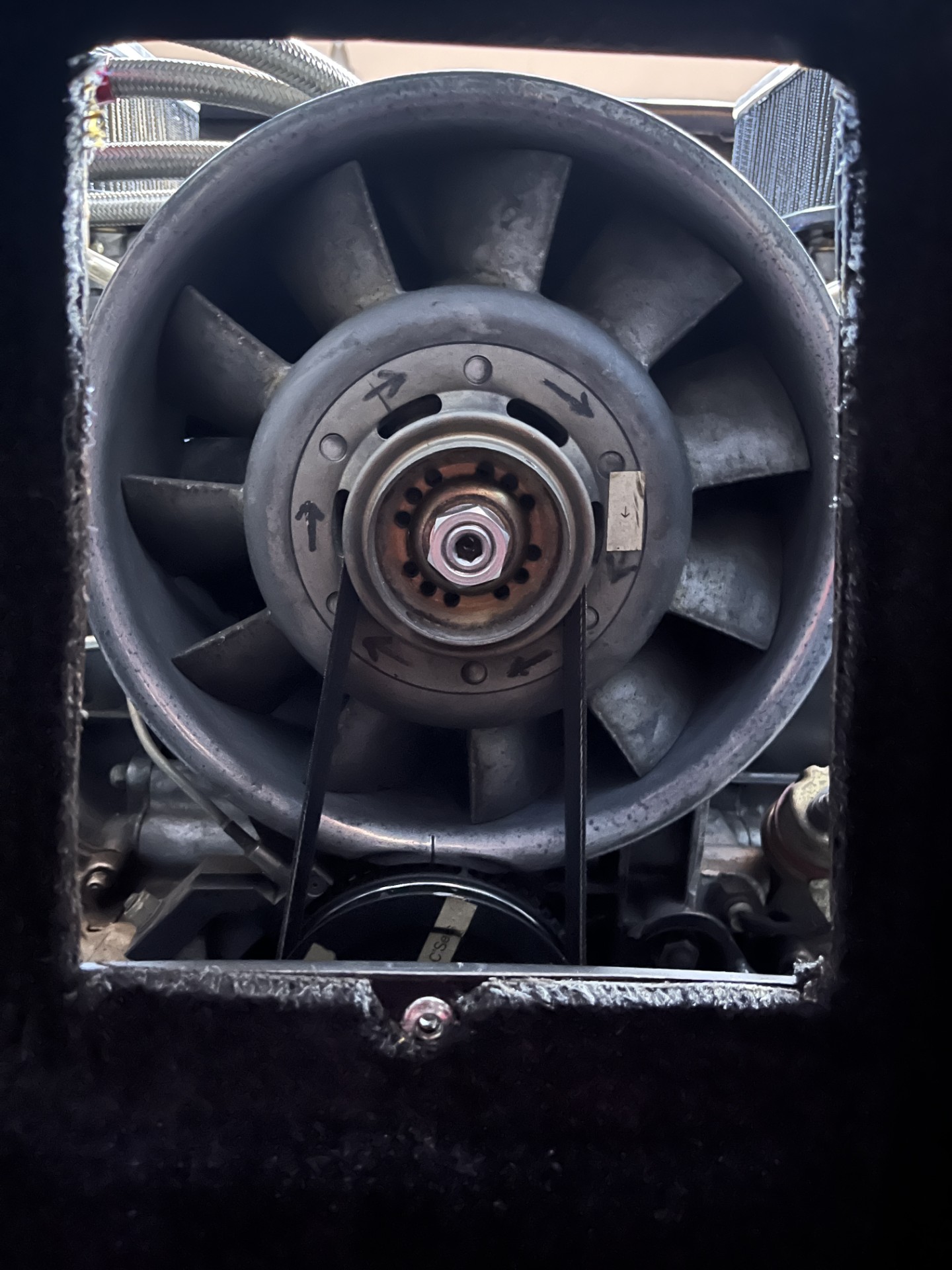

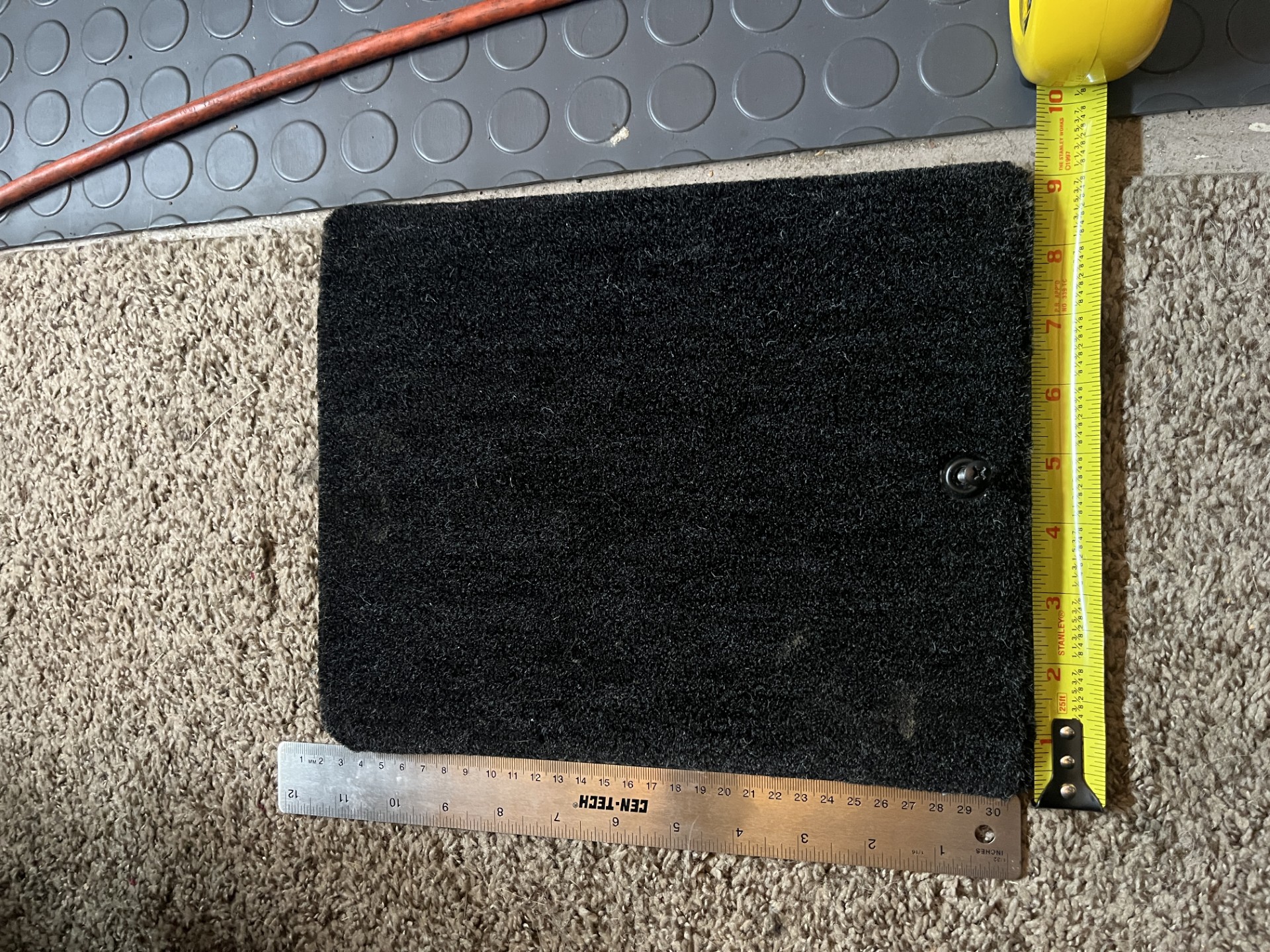

QUOTE(Speedo @ Aug 21 2026, 07:38 AM) *
Anybody? I think this measurement would be a bonus for anyone contemplating an MFI engine swap?
Not an original six, and not MFI but the view through the access hole might help. The cover dimensions are roughly 9x11 inches. Overlap of the cover to the access hole is approximately 1/2 inch on each side.
