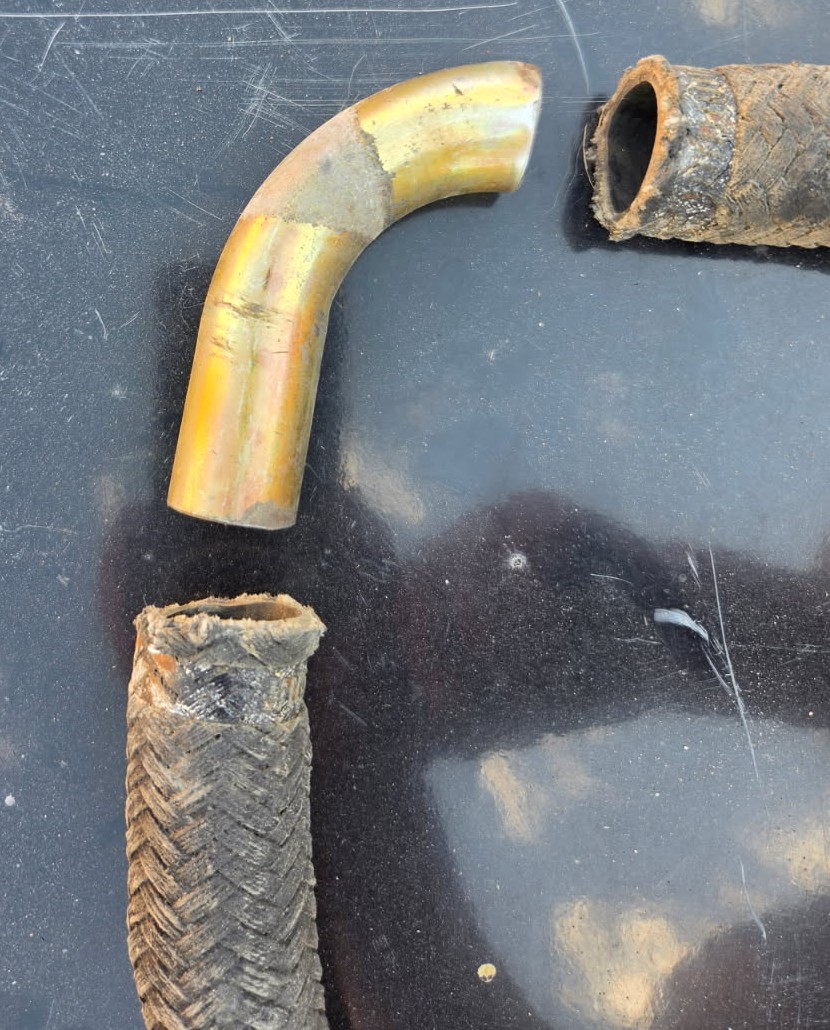

post Aug 17 2026, 12:03 PM
Posts: 11,328
56 yr old.. 90 not a 90.. manipulated..

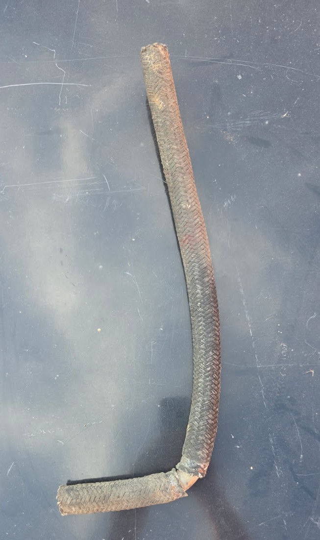

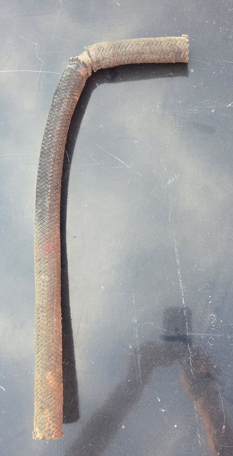

Posts: 11,328
post Aug 17 2026, 12:16 PM
Posts: 11,328
Hose ends notice the amount of push on... and distortion.that makes the weird angle.. Bonus both styles of fillers/vents..

QUOTE(sixnotfour @ Aug 17 2026, 02:03 PM) *
Not sure what the caption means.
All three are 914 6 parts.
The one in the middle is part of the oil tank vent hose. It sits right near the
left rear lid hinge.
The other two go from the bottom of the tank to the J tube on the bottom of the
oil cooler
The 45 degree one is attached to the tank.
The 90 degree one attaches to the hose from the cooler
In the picture both have severed nipples threaded onto the male ends
post Aug 17 2026, 06:38 PM
Posts: 11,328
QUOTE(rgalla9146 @ Aug 17 2026, 06:17 PM) *
oil cooler
The hose ends are for angle comparison ,,I know where they go... You can see how they shoved the hose on the short end and created a less than 90... Thats all ,, use the proper hose ..

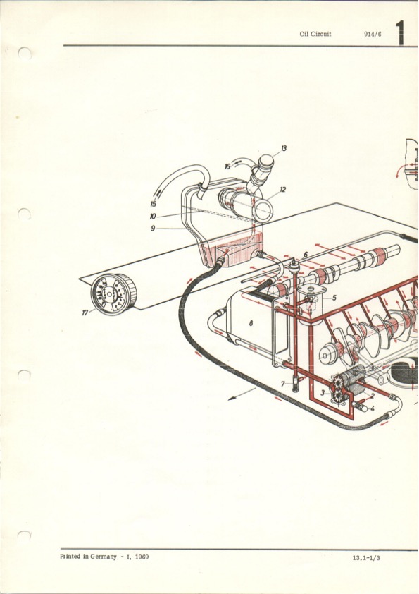

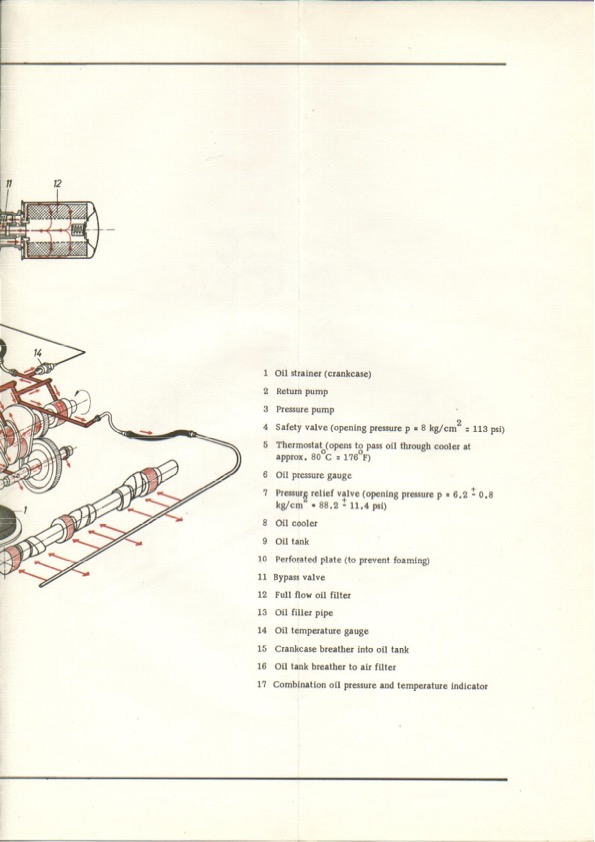

Interesting, the below Porsche 914 Factory Workshop manual pages indicate the engine crankcase breather hose goes to the oil tank and the oil tank filler breather hose goes to the air filter.

Appologies.
I agree about the incorrect length/shape of the vent tube.
The hose can not be properly seated on the short side and often gets frayed by
contact with the hood hinge.
A nice equal length 90 would be ideal.
Rory

QUOTE(saladin @ Aug 17 2026, 09:23 PM) *
100 %

QUOTE(saladin @ Aug 17 2026, 08:23 PM) *
Thanks for this. I completely overlooked that diagram. It appears to confirm the setup I suggested in the original post.
I don't quite understand why you'd have an oil hose connected to an air cleaner, but so be it.
