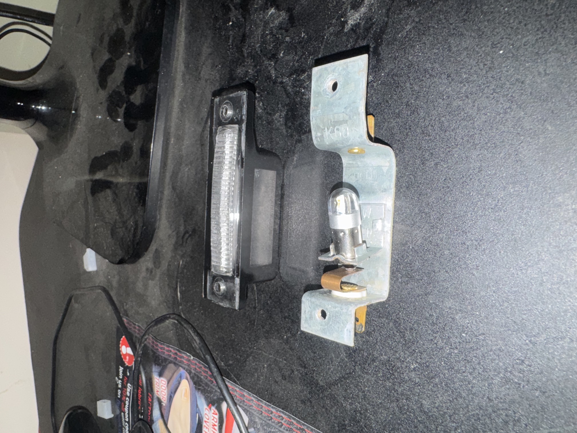

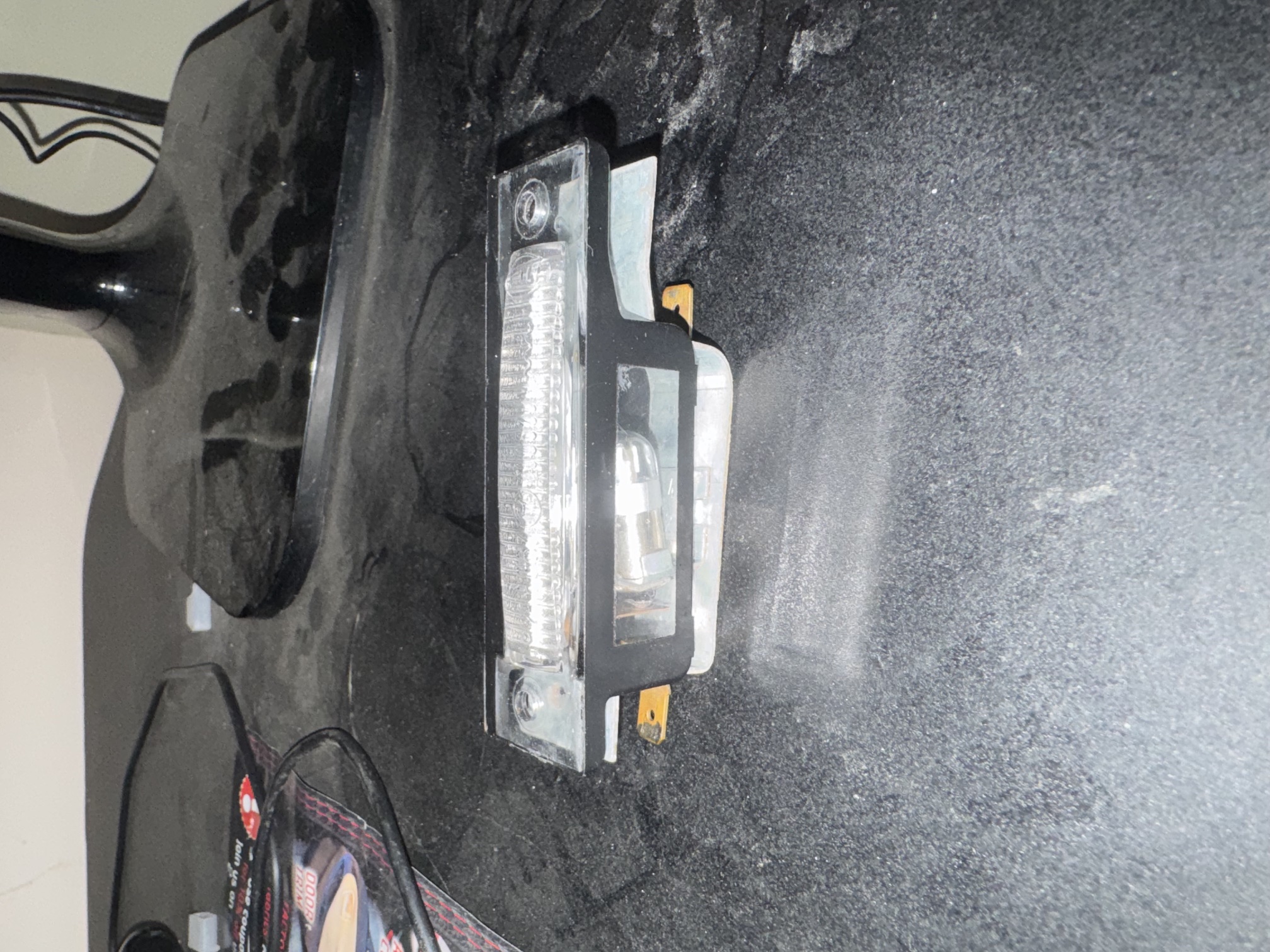

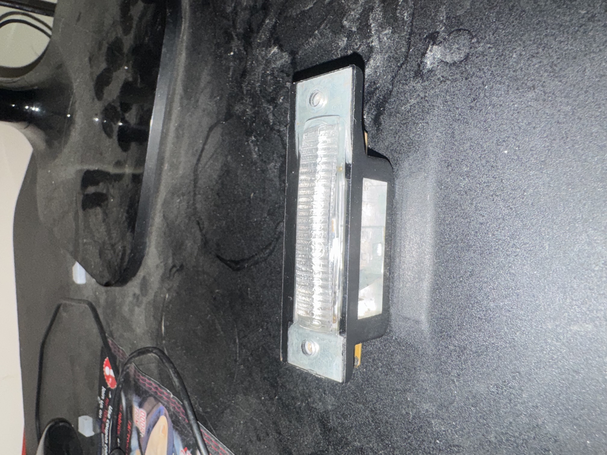

The trunk light in my 72 does not seem to work. First thing to check is the bulb, of course. Easy to get the little module out that sits behind the trunk wall, but then how do you get at the bulb?? The module seems like a single, sealed unit.

Mine were gummed up a bit, it is plastic so I soaked it in soap and water. Then after soaking I carefully stuck a finger nail in at the end between the metal base and the lens.
Once the gap showed I just wiggled it off carefully. It cleaned up nice.

Push twist
Sometime the bulb corrodes in the socket. Squirt some penetrating oli on it
