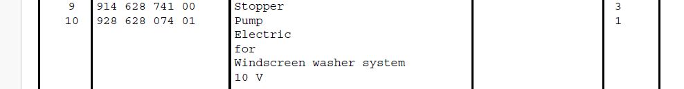

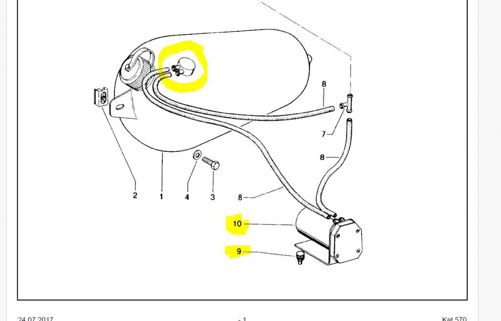

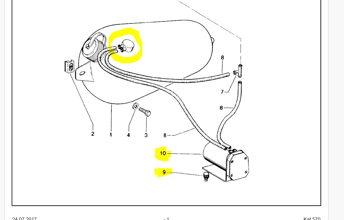

The pump is the same as the 911 (928 number?) one and there are many vendors selling them at various prices, shop around and get the mounting bracket too. The bracket is held to the body via these rubber pin parts to isolate the pumps vibration. This is the way it is mounted on a 914-6.
I got my pump and rubber pieces in 2024 from SMC for ~$25 and ~$5 ea (3).
Then if you want to modify the tank to make it work like a 914-6. Restoration design sells a 3D-printed part to bond on top of the tank.
https://www.restoration-design.com/store/pr...914.628.080.10P
