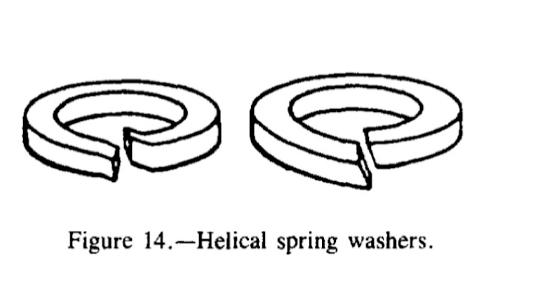

Split ring lock washers were abandoned by the auto industry as well as aviation long ago and for good reason.
They are worse than useless. (IMG:style_emoticons/default/stirthepot.gif)

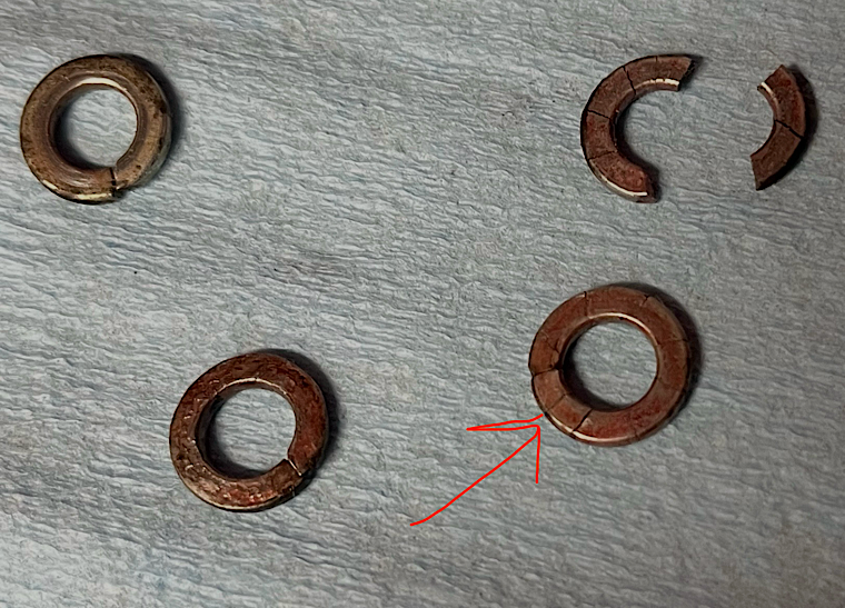

It is well documented that they don’t provide any locking function. I say worse than useless because one of their failure modes is cracking. When this happens the joint loosens, the remnants of the cracked lock washer fall out, and now you have a loose joint.
Here’s a few I found recently that had been cracked and were on the verge of falling out. You will also notice that even the ones that aren’t cracked are flattened and have lost any spring effect.
The inability of a split ring lock washer to provide any locking is documented in NASA literature.
https://ntrs.nasa.gov/citations/19900009424

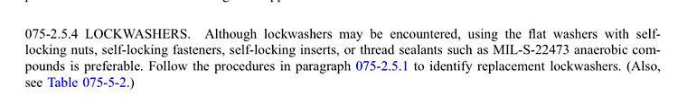

As well as Naval Ships Technical Manual Chpt. 75 that recommends other solutions.
https://maritime.org/doc/nstm/ch075.pdf

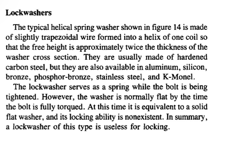

Tried to find a good description of the Junker Test that isn’t blatantly shilling for some fastening solution. Sort of amazing that it took until the 80s and 90s for automotive to finally ditch the split ring lock washers.
If you search YouTube you can find other videos of the Junker Test.
The Junker test isn’t some be all end all test but it is a pretty decent test for doing a rock sort to understand how fasteners can loosen and how that varies by the type of fastener system.

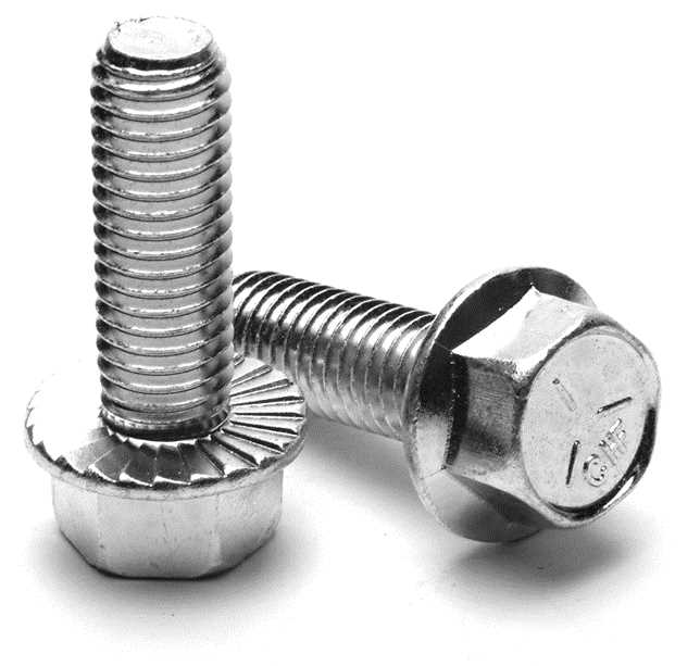

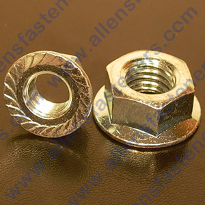

My work around is WIZ (serrated)nuts and bolts. No lock washer needed. I consider these all in one solution.
