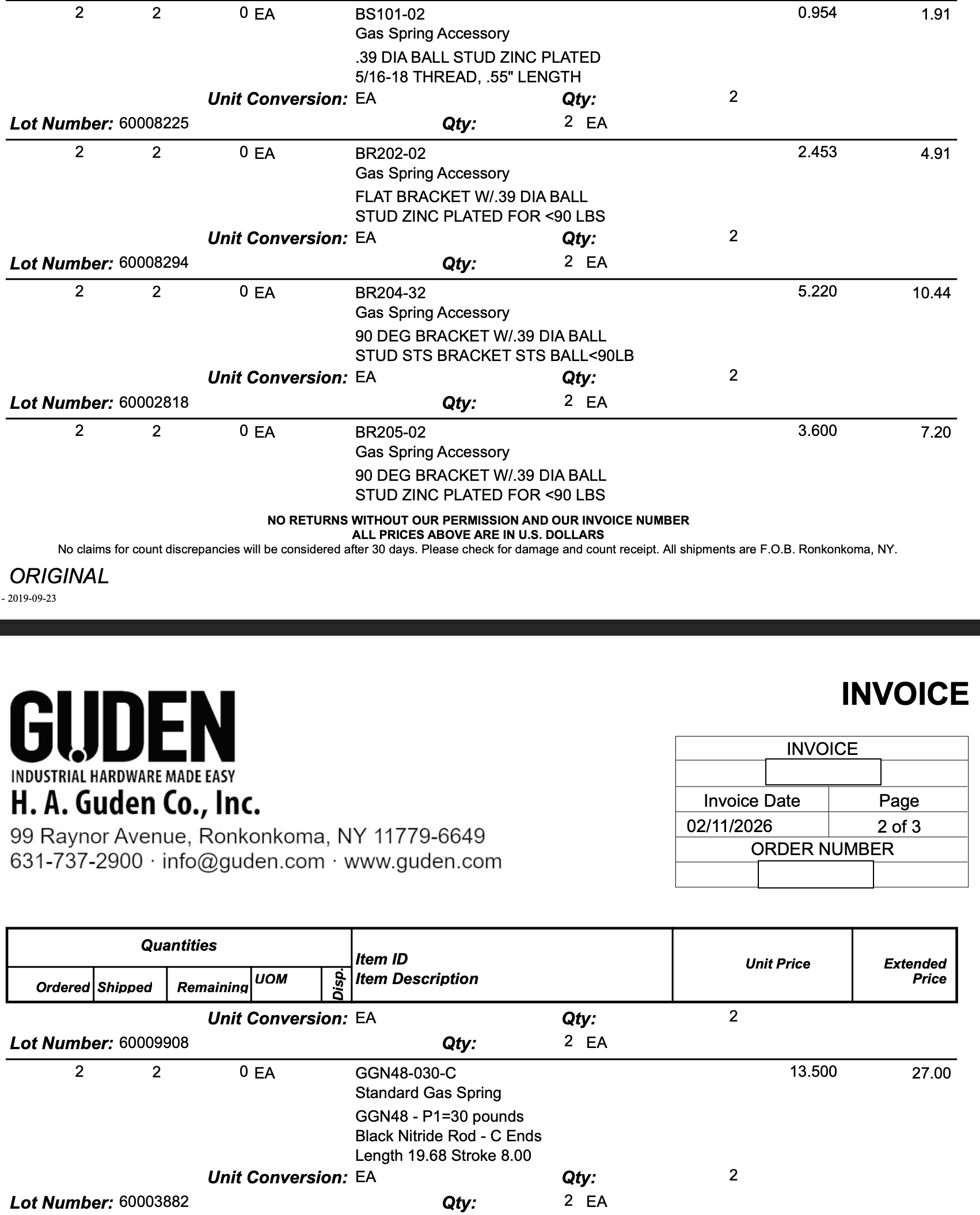

I pieced this together a while back. I got a variety of bracket mounts because I wasn't sure if I wanted to mount to the hinge or hood.

GREAT! Mine are good but I broke one of the clips that hold it to the ball end.
