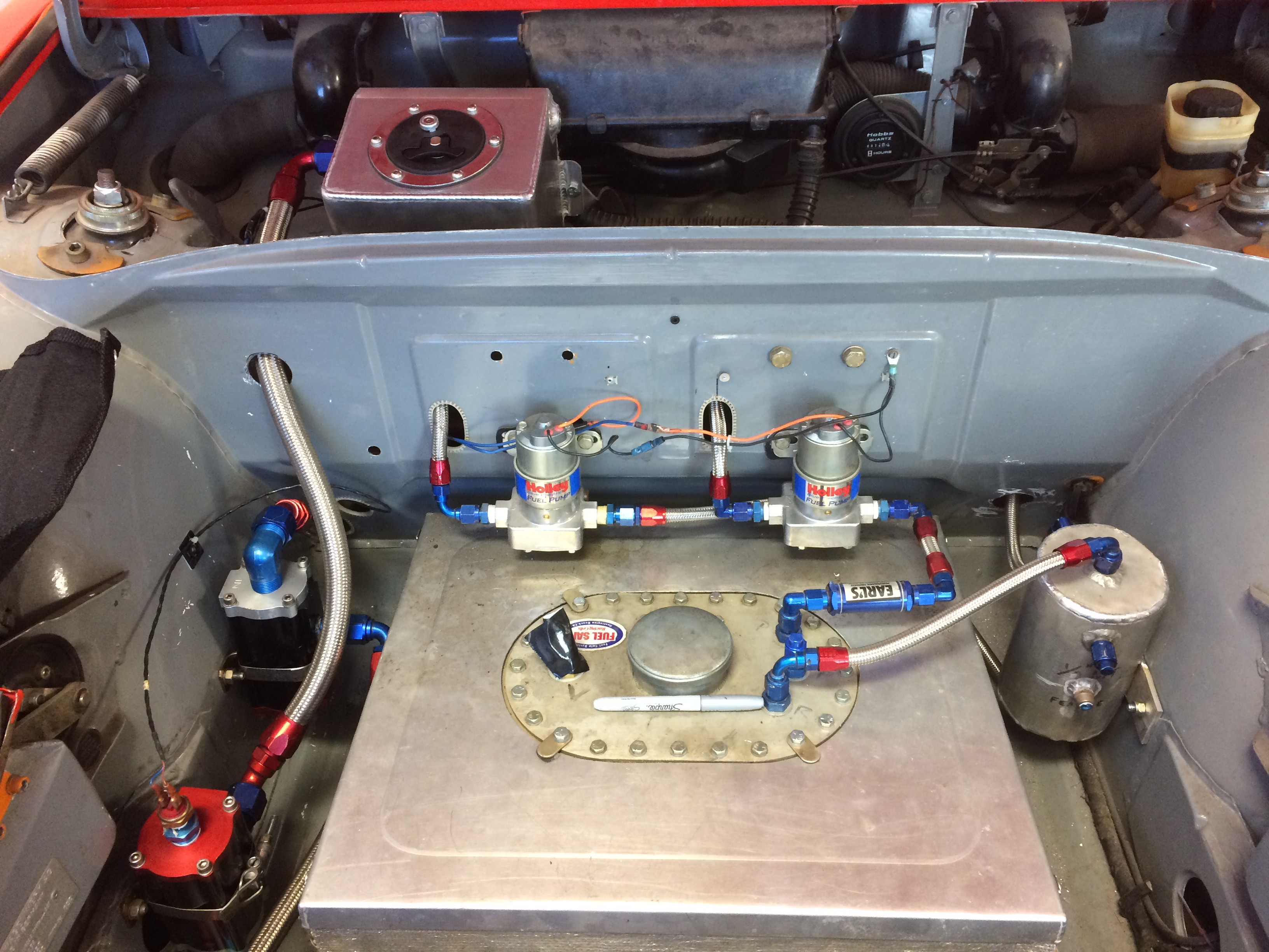

I run that pump on my race car, which is actually registered and plated for the street (so I can do testing tuning verifying)...
Jumping on the above...why? The only reason I went dry sump is because starting in the early-00s we started to get tires that simply were way more capacity than the tuna can could accommodate for long extended cornering. Starting roughly 1999 these engines would not survive on sticky Hoosier tires with extended cornering at places like Lime Rock Big Bend and Watkins Glen Carousel. Even the big drop sumps weren't enough capacity.
But for pretty much anything more, even a long Texas cloverleaf on street tires, it was sufficient. I'm totally fine with the stock system (not even a tuna can) on my street car.
On the other hand, I don't see much of a downside other than money and more systems to manage. It could be simplified from what I'm doing (a Canton sump tank up front) by using a replica 914-6 tank. Just curious why you think it's needed for the street. - GA

There are thousands of these engines out there, highly modified and stock, on street tires "driving spiritly" and there's not carnage of drivers experiencing oil starvation, as long as the oil level is properly maintained. We only came across a starvation problem when running Hoosiers and only on a race track.
A 2-stage dry sump is not going to reduce crankcase pressure significantly, if at all, because the scavenge state is too busy pulling out oil from the sump. And a 2-stage won't clear out the valve covers at all since there's no scavenge stages pulling from up there. To do either or both you'd need more stages, which come with their own complexity (and fitment, since it won't fit behind the fan housing so you'll need a vertical fan housing).
Again, if you want dry sump then install it. I'll even help you design it. I'd personally go with a 914-6 repro tank just to keep it all back there in the engine compartment and make it a sano install. But if you already have, or plan to install, a front-mounted oil cooler (like I have on the race car) then you can mount the tank up front on the panel between the frunk and the fuel tank along with an additional oil filter.
- GA
(In the attached, you can see the Canton sump tank mounted behind the bulkhead, with the additional oil filters bottom left, one pre-cooler and another one pre-tank. Ignore the fuel system routing and tank, that has been replaced).
