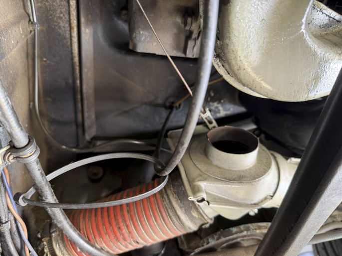

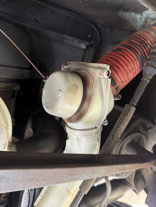

Finally was able to get under the car for an inspection.
Found one side has a cap on what I believe is the heater control and the other side does not. Am I missing a cap or should only one side have this cap?
Oh, Driver side has the cap, Passenger side does not.

Missing something? Yes, the cap on the passenger side. Not sure how it came off...

without the cap, i think that it's dumping heat towards the engine

Any body have a part number for this cap?

there isn't one. it's part of the heat control valve assembly
