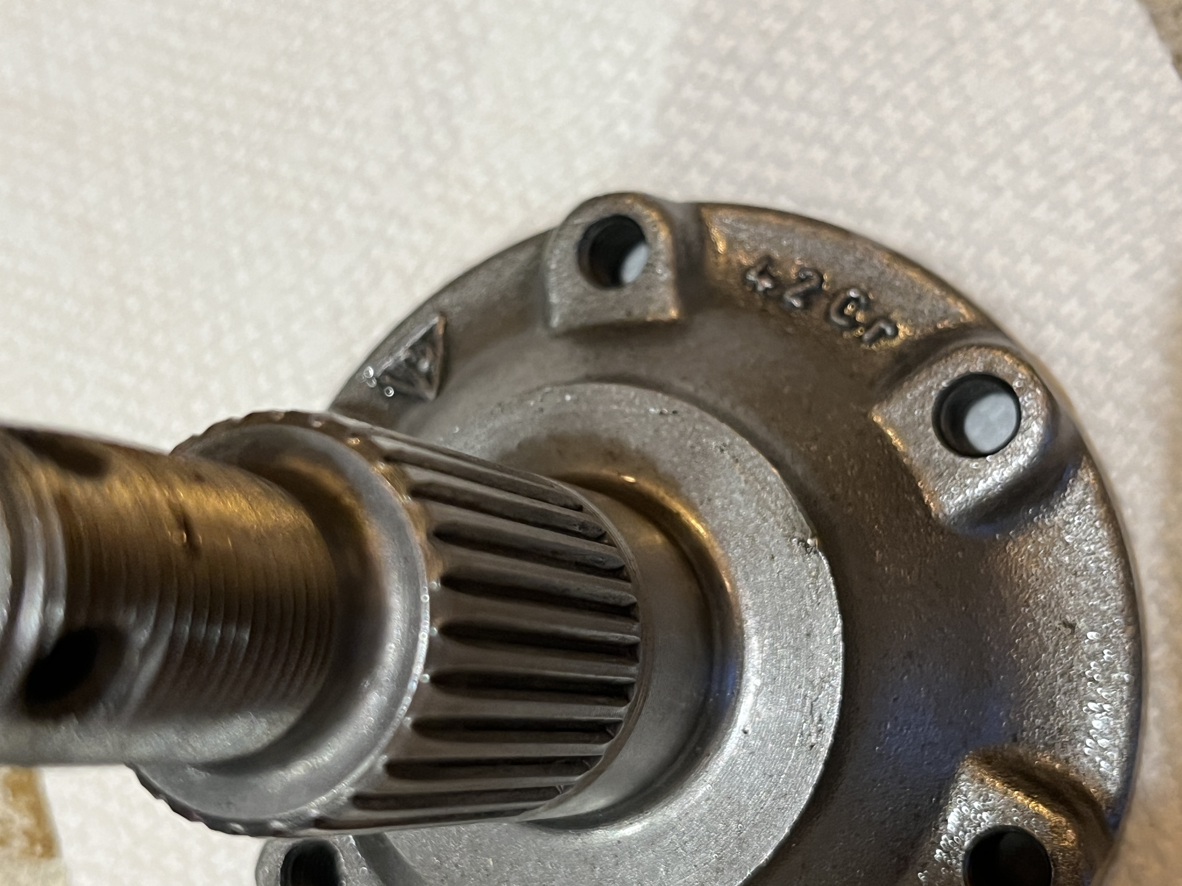

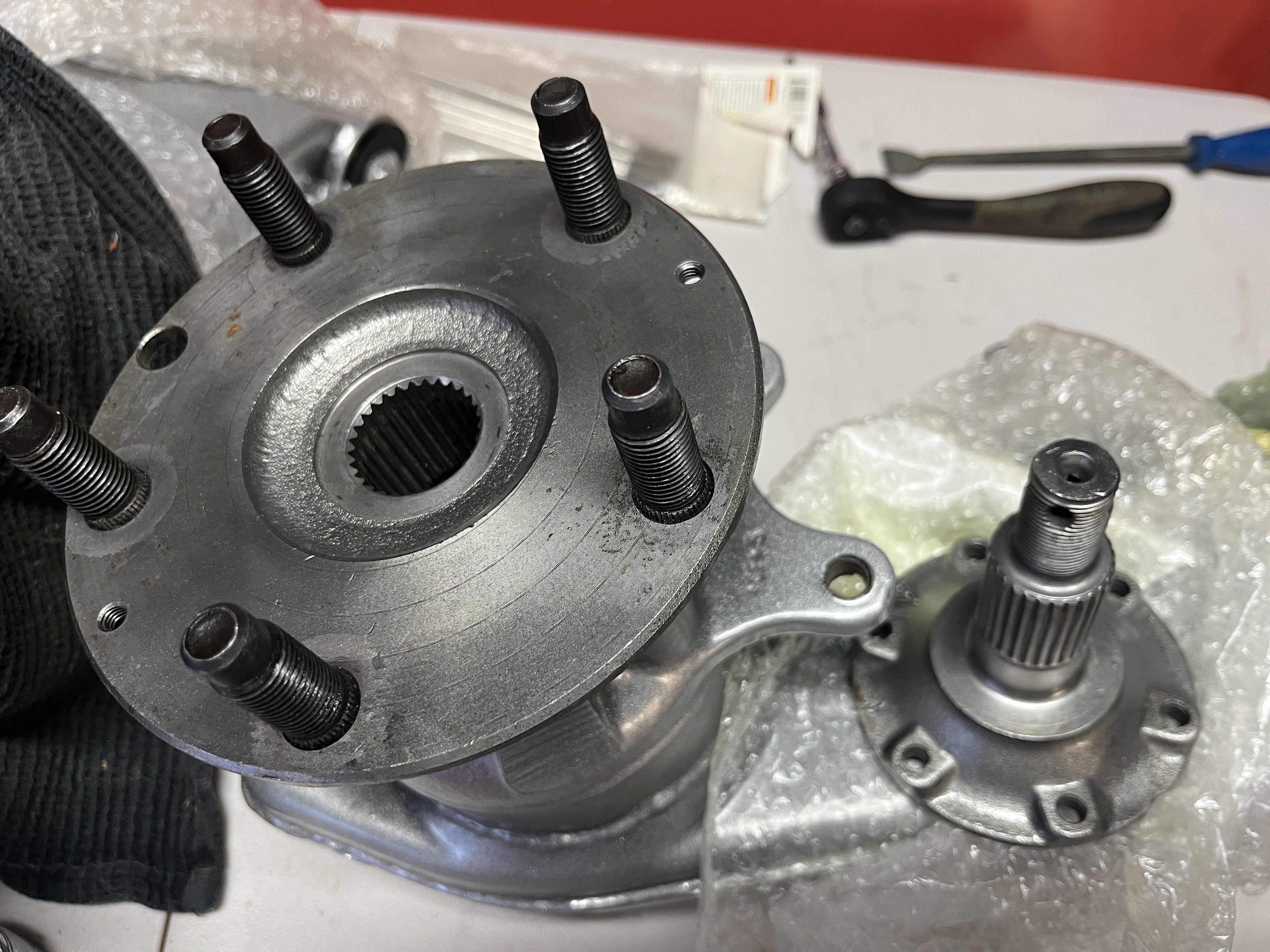

I bought these trailing arms along with the hubs and I’m now getting around to installing them. I’m not sure what I’ve got here? How do I tell if the hubs are from a 911 or something else? Will my 4 lug splines fit this setup?

I maybe wrong you can check, it appears you have a 28 spline 911 hub/ stub axle in the picture. I think 914 is 37 spline

There’s 28 splines. I’m thinking it’s an early 911 hub.
Yes sir. Those are nice, like the 914-6 also.

Will the 6 threaded bosses line up with the bolts for the stock 4 lug cv joint?

If it's the 65-73 911 stub axle
90133223200
That would be the one you want I believe.
I do not think so. Besides the five lug, it was also because the 911 CV's are readily available.
