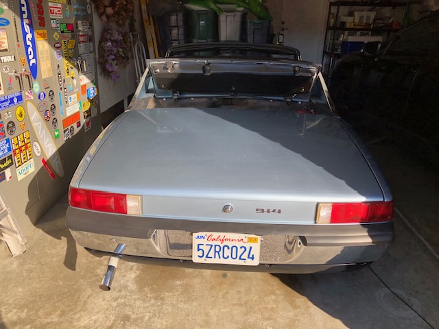

Is there supposed to be a "1.7" badge on the ass of my car?

QUOTE(windforfun @ Jan 8 2025, 06:37 PM) *
Yes! (IMG:style_emoticons/default/beer.gif)
post Jan 8 2025, 10:58 PM
Posts: 9,212
Is it a very early VIN 73?

Gold "914" with no displacement badge says 72 (or earlier) to me. If it's a very early 73, it would be the first with that badging I've seen--but the factory did a lot of odd stuff around the model year switchover, so you learn to be very careful about saying that something "never happened"...
VIN starting with "473" would be a 73 model year car.
--DD

My 1972 did not have one.

If it did there would be 2 pin holes, so there should be signs of a cover up on the inside.

Maybe not.
My early '73 was a 1.7 and did not have the 1.7 emblem.
And the 914 emblem was different also. Sort of a gunmetal rather than gold or black plastic like the '74 emblems.

I had one of those gunmetal gray badges on my 1st 914 back in 80s. I always assumed it was faded annodizing or something like that. I still have it around in storage somewhere.

His VIN is 4732903294

Pretty sure my early '74 (Sept 1973 build date) has the gunmetal badges, both 914 and 2.0.

QUOTE(JeffBowlsby @ Jan 8 2025, 08:58 PM) *
Based off the VIN SirAndy posted, looks like it should have been built 9/72 when checked against other VINs within 200 of that one.

No patched pin holes. Pristine painted inside surface. Black "anodized" badge.

I had ‭4732908732‬ - It had a gunmetal "914" and a black "1.7" but not sure if they were OEM or not. I still have them....George has the car in a field somewhere....

My early 73 (#662) has the 1.7 badge.
